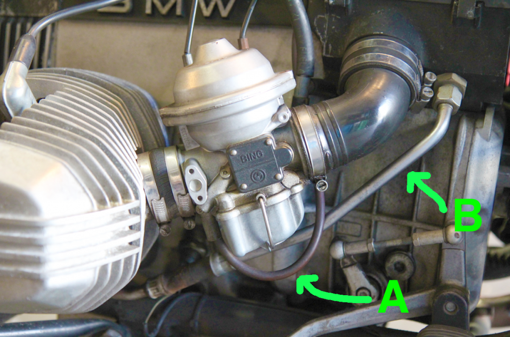

Hello.
My '84 owners manual doesn't say anything about tuning the carbs and clymer says take it to the dealer.
I want to believe that it's safe for me to do this job at home. my friend has a TwinMax (and a R75/5), but we weren't sure where to plug it into the carbs.
I'm guessing it goes where the tube marked "A" in the picture below goes. Is that right? (And what is that tube and what does it do?)
Bonus question: What is the metal pipe marked "B"? It comes from the cylinder to the airbox. CO emissions control?
Thanks! Danny

A, is the vacuum line that goes to the valves in the airbox, with higher vacuum the valves open and allow air through the tubes B into the exhaust valve port of the cylinder head .
To use a manometer, or Twin Max, you pull the rubber hosesoff of the carbs and put your tester hoses on there .
Just remember to put the hoses back on, or the engine will run poorly . ::)
