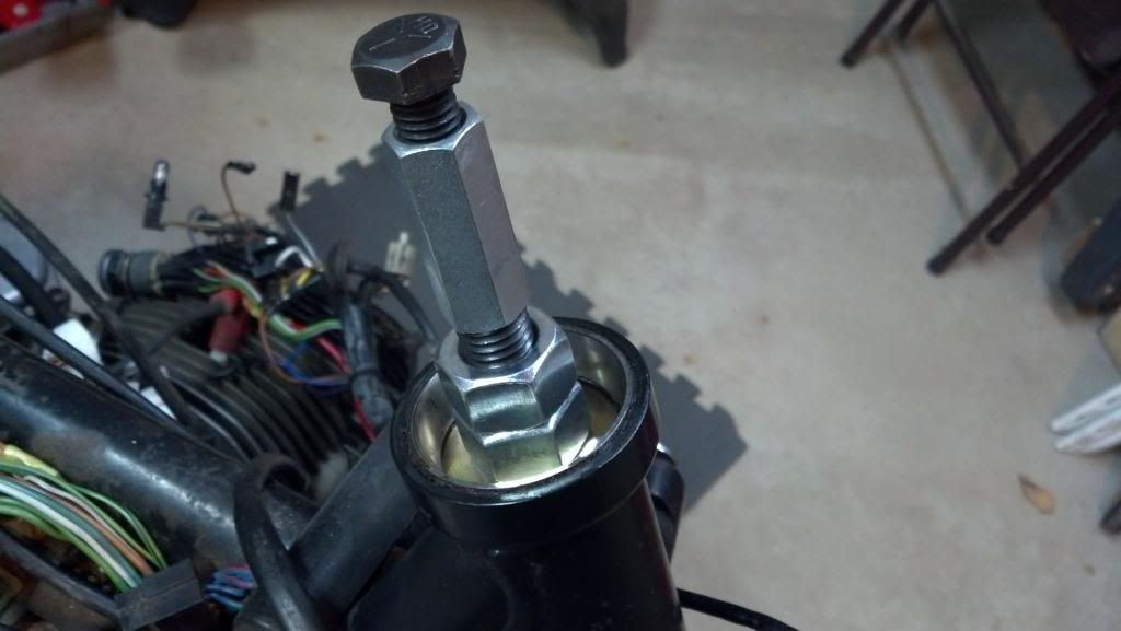

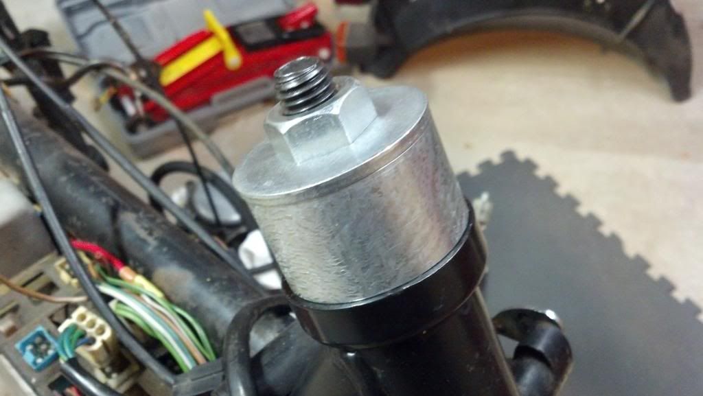

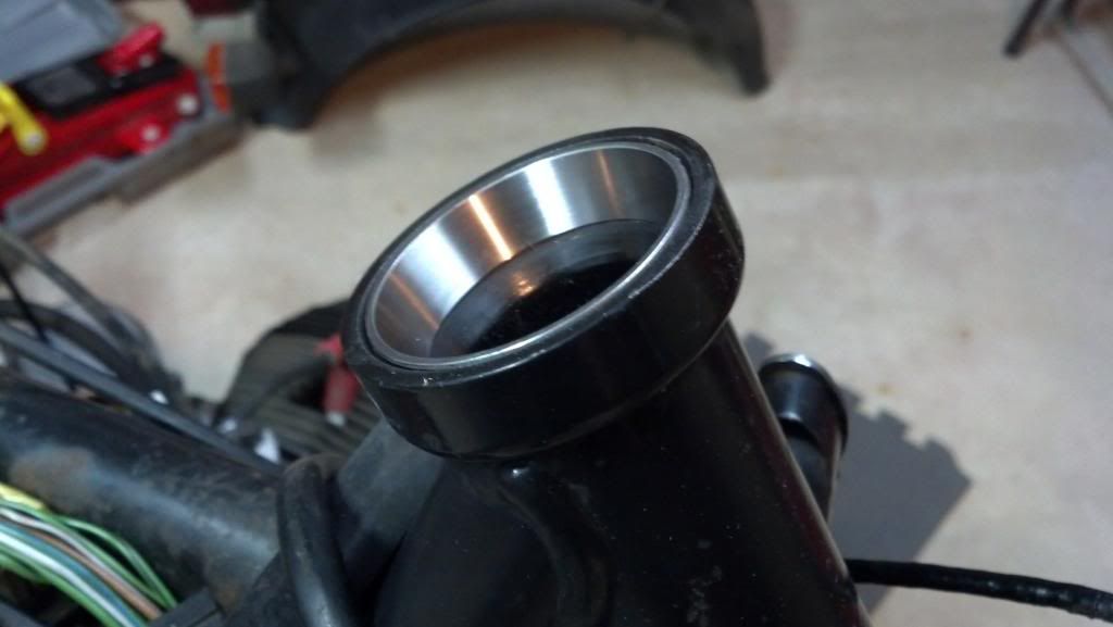

I've installed new bearings. I bought the cycleworks tool for removing the outer races:
The top came out easily, the bottom took quite a bit of torque on the wrench. But the frame bosses looked good, all is well.

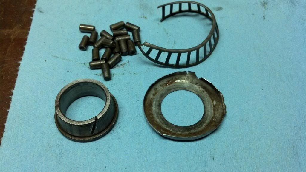

I didn't buy the tool for removing the lower inner race.  Instead I used a Dremel to cut the cage and make a groove in the race, a couple taps with a hammer and chisel and she's free!
I used the old races as a drift to tape the new ones in place

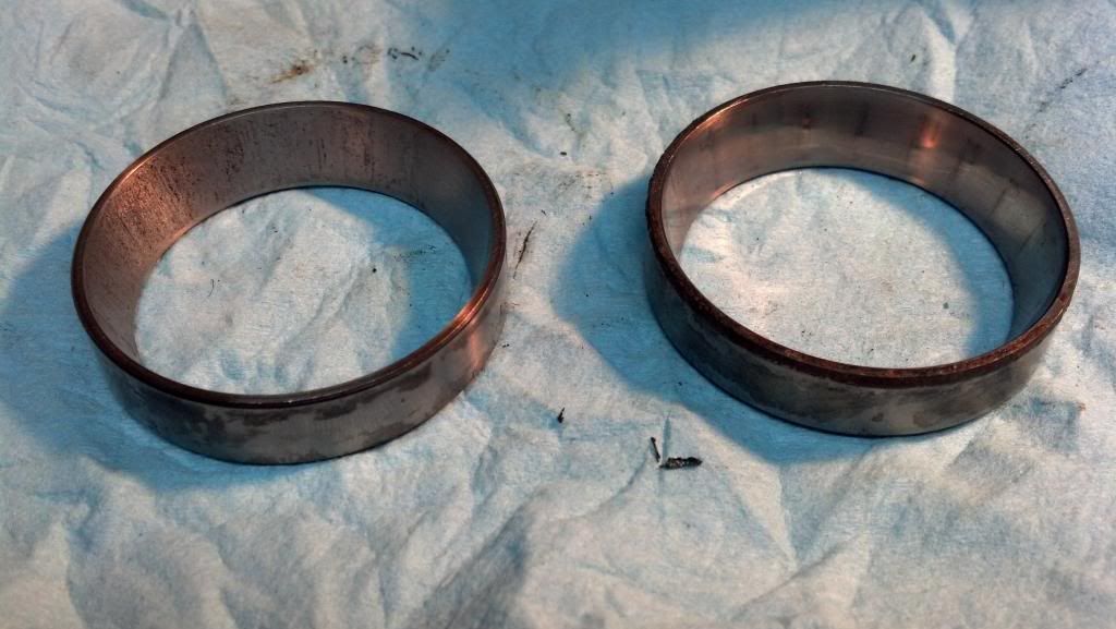

Question: I saw on the Motobins Tips page an article about electrical erosion on the stearing head races. These are my old races. Is that what I'm seeing on the upper race(the one on the right)?
Re: How to remove steering head bearings?
« Reply #21 on: November 03, 2013, 11:33:08 AM »
What you're seeing is bearing races that have been damaged by being either over or under tightened. The term is brinelled. Actual low spots that have been pounded into the races by the bearing rollers. Usually felt as a notchy steering when pushing the bike around the garage. Or, it could be false brinelling...
Proper preload is essential for long bearing life and smoother steering during ops. After you've completed the rebuils and a few miles have passed below th eoil pan, you will want to readdress and adjust the preload on those new bearings.
Brinelling  http://en.wikipedia.org/wiki/Brinelling
False brinelling http://en.wikipedia.org/wiki/False_brinelling
One of the first things I had to do with my freshly purchased '83 R65 was replace the steering bearing. Not too pretty...

ouch, that one looks pretty bad!
I was talking about the vertical lines "ghosted" on the upper bearing tho. I can't feel them with a fingernail, I was wondering if they're electrically-caused.
« Reply #23 on: November 03, 2013, 01:19:05 PM »
I know the motobins article you mention and the theory about electrical erosion. I also know who wrote those articles and it wasn't Motobins themselves but a guy called Mike Fishwick who was the Technical Officer of the BMW club. Mike is very knowledgable and experienced but on this one I've never been fully convinced or at least I would want to see it better explained.  The idea that there is a fortuitous earth path through the bearings doesn't make obvious sense as there is already a perfectly good earth via the wiring harness.  I have actually tested the earth between the forks and main frame while turning the bars and saw no change in the reading so I assumed the main earth path is fine. The possibility that it is the high voltage impulse to the Tacho that might have something to do with it does spound plausable as that pulse can be 250 Volts but I still don't understand why the forks aren't already earthed via the harness.
