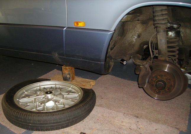

Done that, too! Usually use a couple bits of scrap wood to spread the load such as in Barry's photo.

Barry, I hope there's something I can't see in your photo above keeping your wheel from pushing directly against the floor.  My spare 16" ralley wheel off my Chevy (or Toyota 4WD, they both use the same wheels) is perfect, but if it's not handy I'll use a pair of 4 x 4 boards.  I always have chunks of scrap lumber around.
