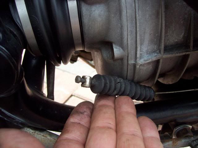

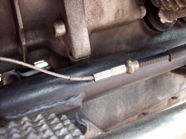

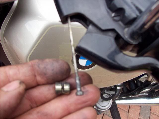

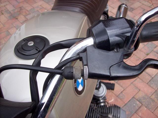

screw the cable adjustment back as far as it will go and remove any cable ties or fixings
disconnect the nipple on the clutch lever (use a small jemmy to move the arm forward if needed.
Slide the cable from the gearbox mounting flange
The lever nipple will now slide out and remove the end link.
Re assemble in reverse with the new cable
