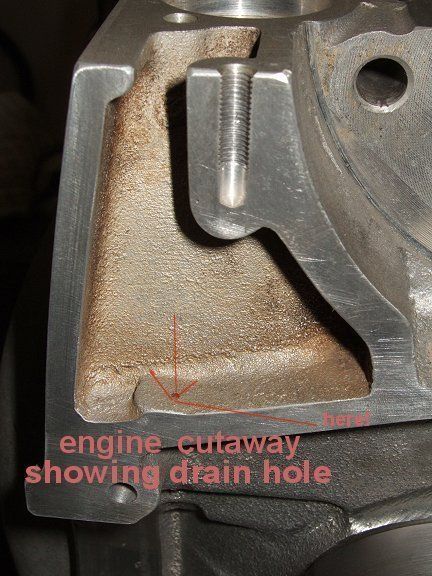

I finally have time to trouble shoot the oil burning problem with the R45.  Off came the tank and the lid over the starter. found the crankcase breather.  Now comes the hard part.  Where do I find the feedback hole?  Do I need to remove the starter?  Or is it buried under the breather?

As I've also been examining things in this area on my 78 R100/7 (which is apparently quite different, or else is missing something) I found this very helpful weblink --
you won't likely see the oil return hole unless you go down deep looking for it...
http://www.bmwscotter.org/procedures/oil_breather_service/oil_breather_service.htm

From the website link -
the drain return hole is apparently at the bottom of the "settling chamber" - assuming that your engine case has one ?

I couldn't see any sign of that chamber on mine.  When the breather valve is removed it goes straight down into the crankcase.
If the picture had zoomed out a bit it so we could see exactly where it was supposed to be, it would have been more definitive in settling the question beyond doubt "do R45/R65's have the hole"
We talked about this on another thread 3 years back and I think we concluded that our bikes don't have the hole. http://www.bmwr65.org/cgi-bin/yabb2/YaBB.pl?num=1269278421/1#1
I've got to admit I'm still not 100% certain about our bikes not having drain holes but reading the Scotter's article again If I had to guess I would say only engines with the bottom covers have drain holes and that's not us. It seems to confirm that our crankcases are different.

I believe the portion of the round hole you see at the top of the photo is the breather hole with the whole thing removed.  On mine, there is no additional hole.  Just the sunken cavity where the starter is, and the one to the rear where the air filter goes.
The breather cover on mine looks like drawing # 2.  P/N 11-15-1-335-756.
I've looked at Bmwscotter and SnowBums page.  I printed out the drawing and sat next tot he bike, trying to match things up. Mine doesn't much look like the drawing (with the oil system highlighted in magenta).
« Last Edit: April 23, 2013, 10:52:02 PM by DeeG »
Yes, that's what I thought but I wasn't certain. I also have the 11-15-1-335-756 cover.
I think we can now say with some confidence there is no drain hole in early R45/R65's.
