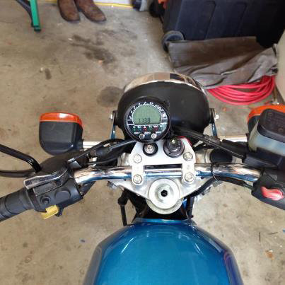

Recondtexas has not yet set up a web-based photo sharing program so his old man is posting his completed Acewell installation photo.
Turned out pretty slick. Check out the OEM ignition switch placement.
From Radio Shack, a small 12v wheat bulb with a red lens has been installed in the steering crown nut serving as the GEN lamp location. Zach also has the solid-state back up circuit fitted.
New headlight brackets and some vintage BMW front turn signals -scored from my Beemer stash- mounted on the headlamp brackets using the stock R65 wiring. Says he has ordered, from Dime City, a Lucas-style tail lamp that will marry up with a soon-to-be modified R65 rear fender sourced via eBay.
Don't mean to steal his thunder but his work is very clean. Props, recondo. ;)

  • Posts: 9145
Re: Acewell install on 83 r65
« Reply #10 on: January 27, 2013, 07:49:46 PM »
Good looking installation !!!
I've never seen the display working before, does the tachometer and speedometer display both at the same time .
A cost effective way of doing away with the OEM indicators when they need repair .
