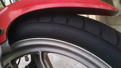

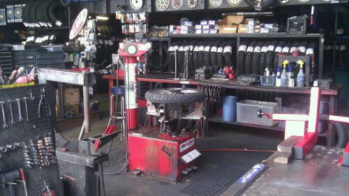

Took my rim and 90/90 tire to another motorcycle tire shop this morning, and the guy there got it on without too much trouble.  He did say the bead was pretty stiff, but plenty of lube was all it needed to pop right in.
I'm still upset the first shop I went to sold me a tire and tube I didn't need, which went flat 2 hours later.  In addition, the tube he installed was much too big for the tire.  It was all bunched up in there!  That can't be safe.  I'm a bit worried he did a shotty job on the rear tire now.

« Reply #34 on: July 03, 2012, 02:07:20 PM »
By all means check your rear tire!
When I bought my LS I found a bunched up tube and the tire held pressure!
Insanely unbalanced. Check he used appropriate 4.00-18 tube.
