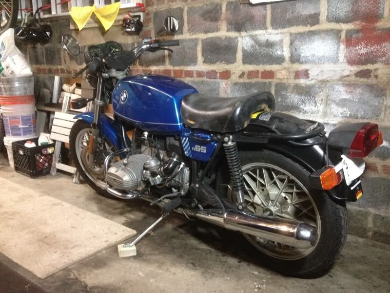

Bike as I bought her.

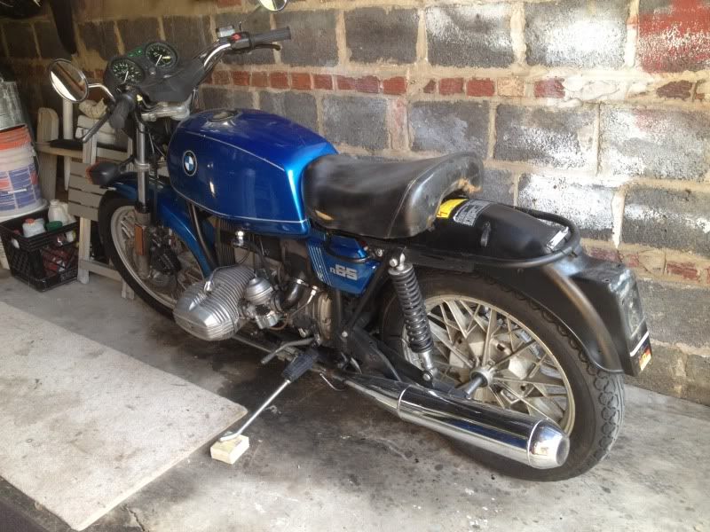

Removed the racks, fairing, and recovered the stock seat.

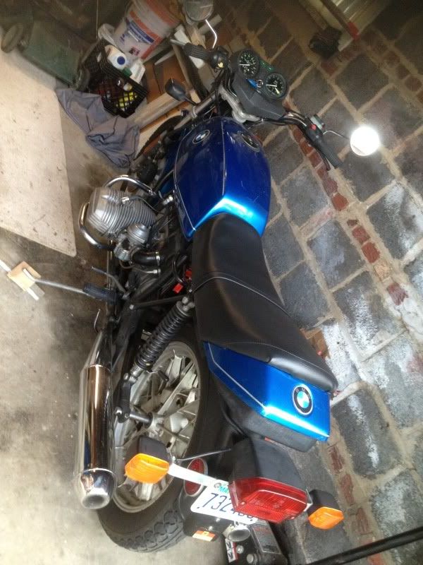

Added the solo seat.

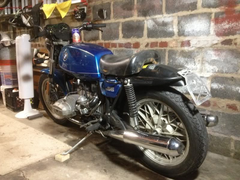

Removed the crash bars.  In the process of replacing the brake and turn signal lights with a 3 in 1 unit from Hyperlites. Bobbed the fender last night using a Dremel tool and a fiberglass cutting bit, like a hot knife through butter.  ;D
The license plate holder is from BoxerMetal.  It comes with a Lucas style light so I'm planning to cut it down some and rivet the Hyperlites mounting bracket to it.
I was enjoying a couple Fat Tire beers, which seemed somewhat inappropriate after the fender bob.  I couldn't help but notice how skinny that Metzler is now...  But I like it.
