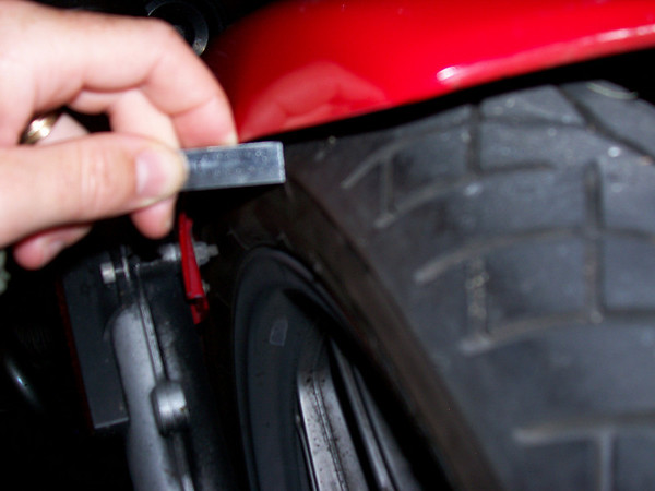

sixfifty
Re: Battleax 110/90/18
« Reply #4 on: September 12, 2009, 10:20:23 PM »
i have a 100/90 on the front of mine, and at a couple of places i can't wedge a fingertip between the tire and the fender.
i can go measure if you'd like.
edit:
it's roughly 5/16", give or take with the front wheel off the ground.  my fender is a little off-center.
