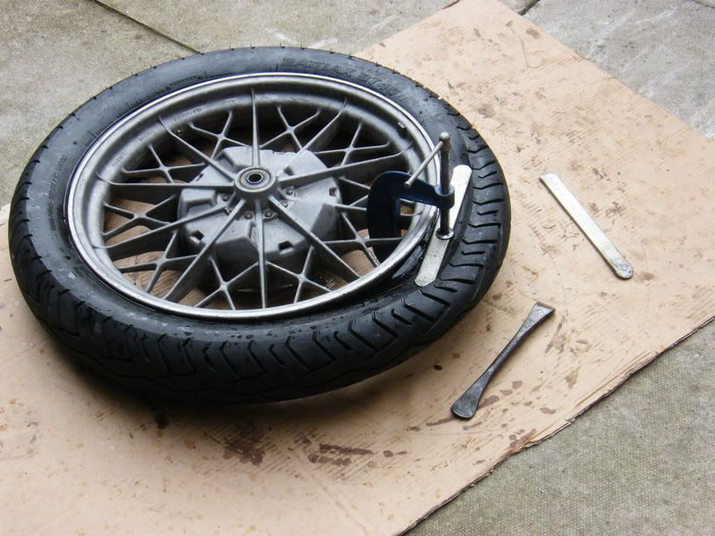

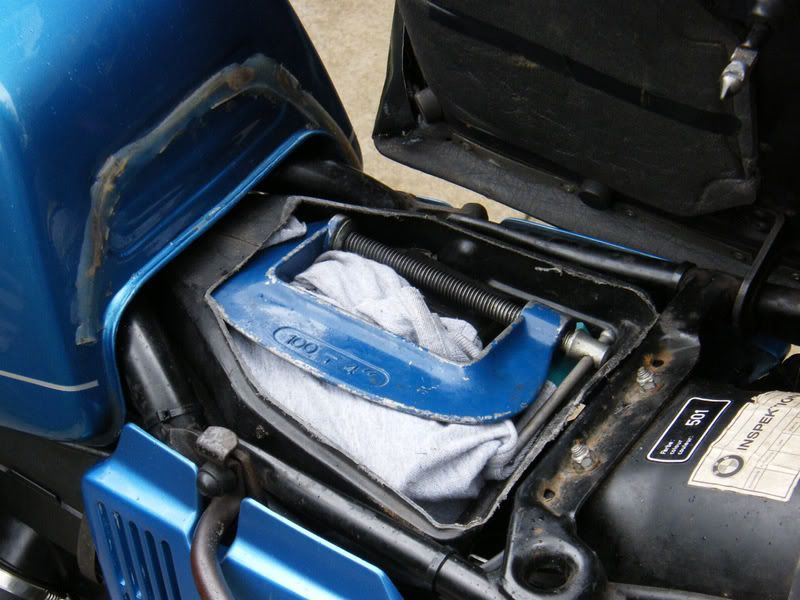

Small G clamp a tyre lever and the small piece of plywood I carry to pop under the sidestand on soft surfaces (to protect the rim) make up my (easily carried, levers fit up inside the frame tube) tyre changing kit. I use Bridgestone BT40s which are pretty tight to get on and off, So,,,, I prefer shorty tyre levers so that I can't put excessive force on the tyre and damage it. Adequate lubrication, technique and a little practice are the secrets to tyre fitting.

« Reply #31 on: July 05, 2009, 01:35:57 PM »
G cramp is a nice idea.  I'll try that next time.
