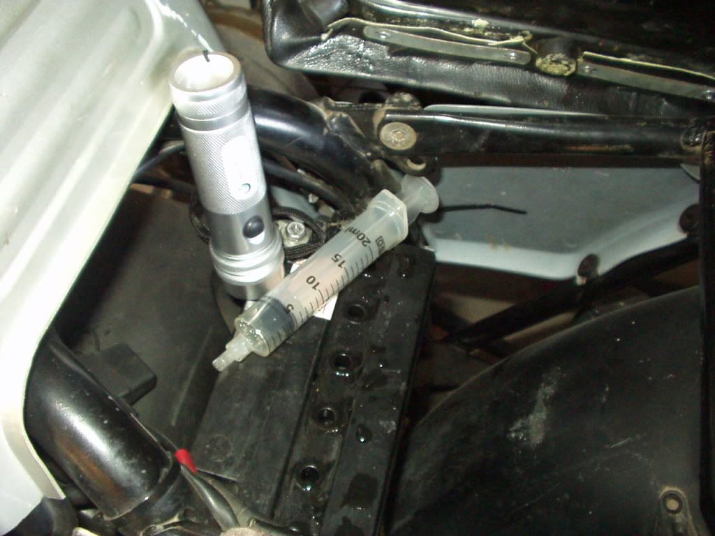

Us poverty riders don't have fancy jell filled, glass mat, dilithium crystal batteries in our bikes. We have bubbling lead acid batteries and when it comes time to add juice to 'em it's a pain. A handy tool is a 20ml syringe available at the drugstore or get one of those "cajun maranade injectors" at the market. They work a treat. Squirt distilled water in perfectly and even draw off some if you misjudge. Great at blowing a puff of air to clear the fill hole of a bubble so you can see the plates. Cheap & easy does it.

Love the flashlight, Rich.   Shame the camera flash washed out the logo.
 ;D
Ed
Re: Poverty riders tech tip #3
« Reply #2 on: May 30, 2009, 08:09:53 AM »
Roger the Official R65.org flashlight. I put away my MiniMag when working on the bikes. We lost power this week during an serious electrical storm and the R65 light lit up the room until sun up.

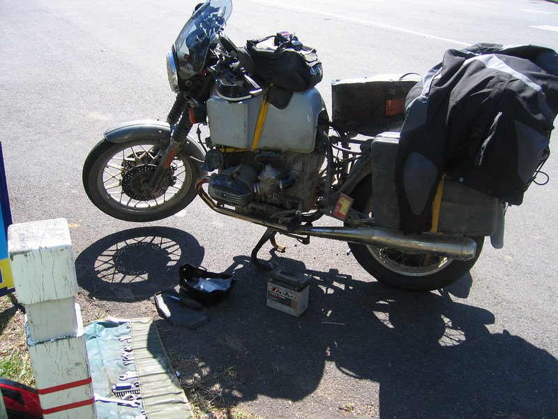

Interesting looking gas tank, Gadget...
Andy-Gadget
« Reply #8 on: May 30, 2009, 06:20:10 PM »
It was build by a mate to fit behind an '81 RS fairing, hence the retrofitting of a round air filter on this motor, which is an '84 RS motor.
Lots of compromises to clear low handle bars, knees ans fairings, hence it shape, it started life as a 90/6 tank, I think.
Holds about 40 liters.

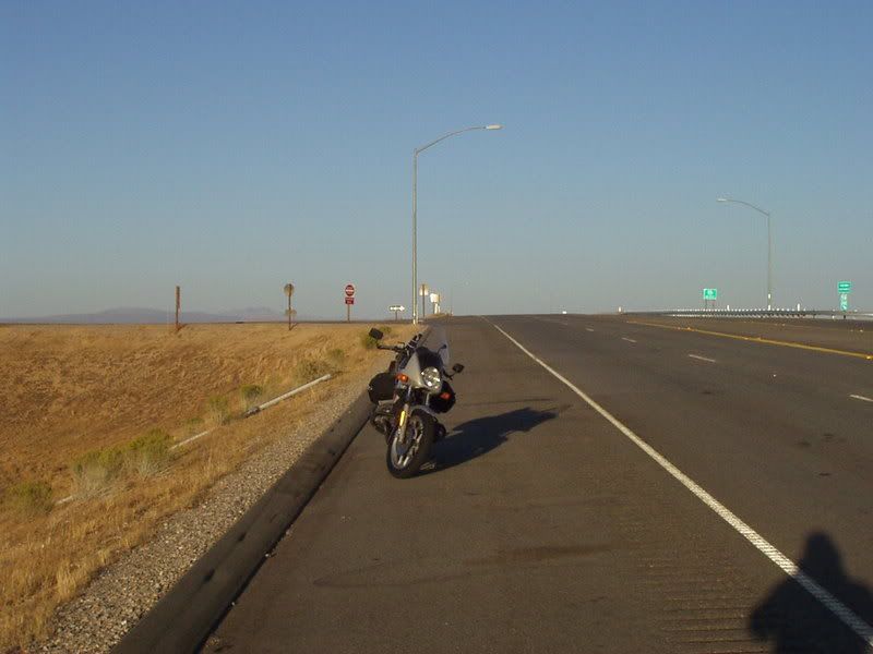

« Reply #11 on: May 30, 2009, 07:54:47 PM »
I don't think my arse would last long enough to burn that much in one sitting!
Agreed, the point was to go to places that a standard tank wouldn't allow.
The road less traveled is usually the most interesting, but less serviced.
Kinda like this [outside Barstow Ca]

  • Posts: 5999
« Reply #13 on: May 30, 2009, 10:29:20 PM »
Yeah, that pretty much looks like the proverbial "middle of nowhere"...  :P
