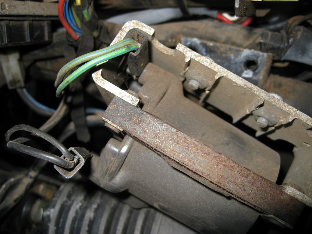

If the old coils is this colour, change it regardless.

If you're still running the OEM Crack-O-Matic ignitiom coil, pull the tank and inspect the coil for tiny -really tiny- cracks. You may need to clean the item first. Cracks can be longitudinal or on the ends, often a circular pattern.
