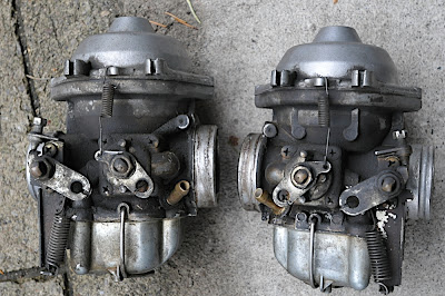

I had the same problem as you.. Mine was probably the gaskets for the choke assembly. They were shagged when took apart my carbs.
if your carbs look anything like below.. it is probably an air/fuel leak
