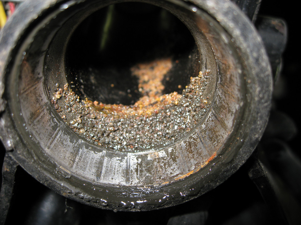

A word of caution, if your steering head looks like this one, pumping grease in won't help.
My plain Jane R65 needed to come apart because the steering felt horrible.
I am posting a photo of a steering head full of sand, but I can't directly link yet as I am new here, and the preview doesn't show an image, so I don't know if it will work.

Image of bad steering head, I hope.

How did all the sand get in there!!!???

I wish I knew, but you can imagine what the steering felt like, probably why I got the bike nice and cheap.
That looks like Rusticles  (Hellooooooo Titanic)....

Wow - that is very seriously damaged - one can see all the grooves from each roller as well!   I'd expect to see something like that in an extremely worn GS machine ridden in the Sahara.
