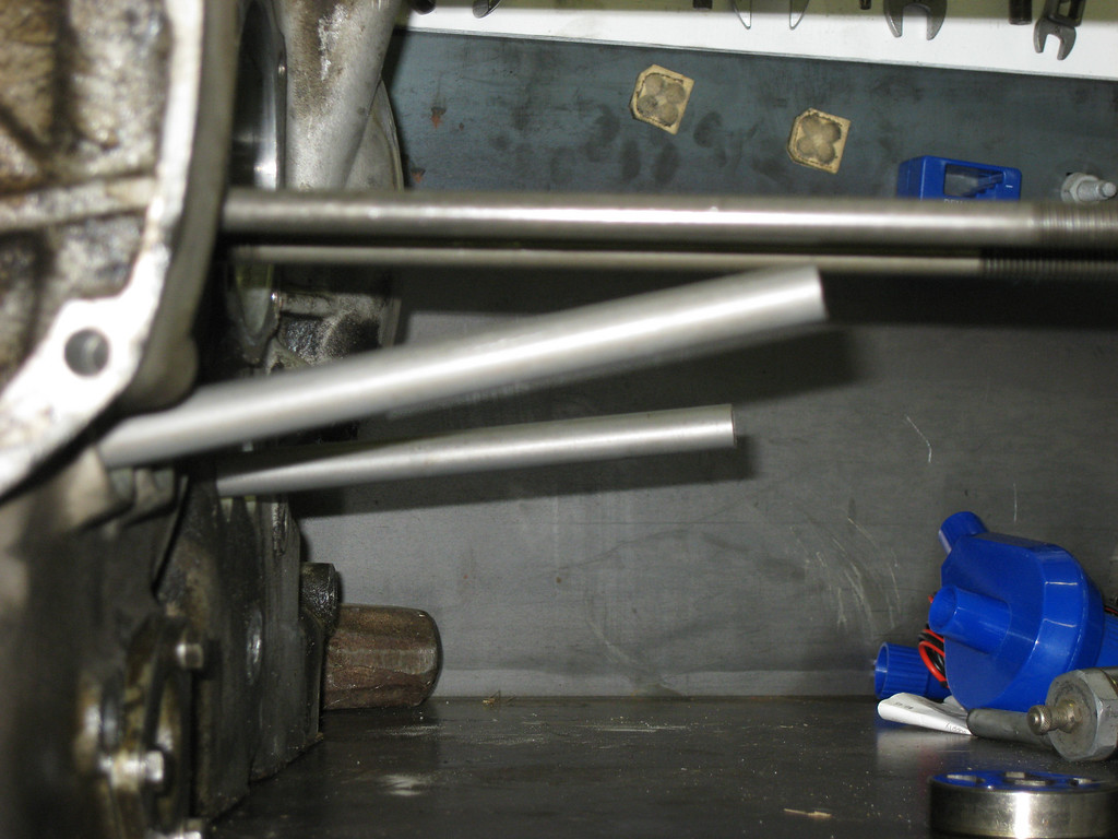

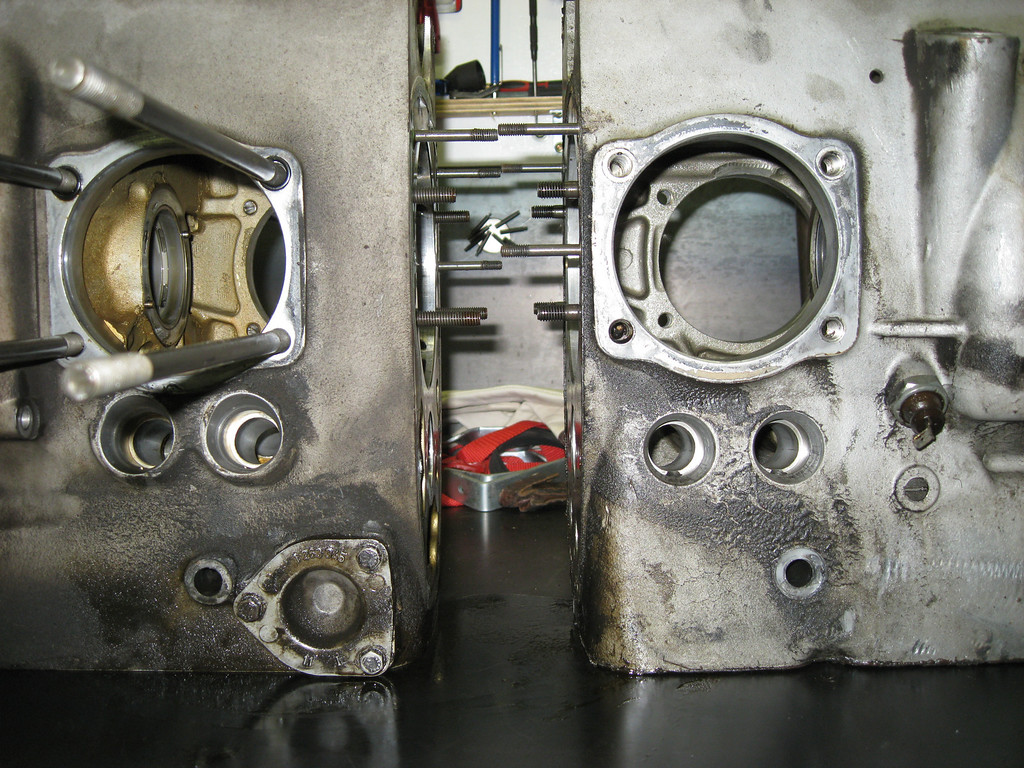

R65 case in front, R80 case behind, note angles of tubes in follower tunnels.
R65 case on the left, R80 case on the right, note angle and position of push rod tube termination.

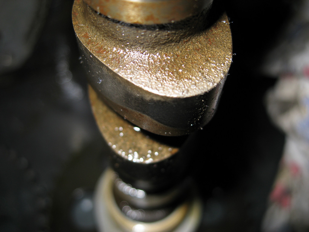

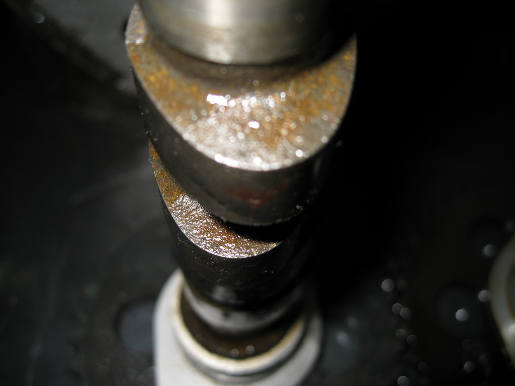

Cam lobe phasing, R65 inlet.
R80 inlet.
Bottom line, you can play mix and match to your hearts content with the long stroke bikes, you have very little wiggle room with the R65.

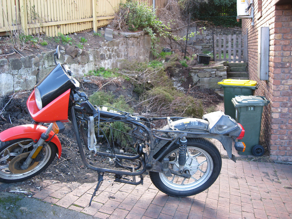

Andy-Gadget
Re: Difference between long stroke and R65 cases
« Reply #4 on: April 28, 2009, 04:41:26 PM »
R100 motor in LS.

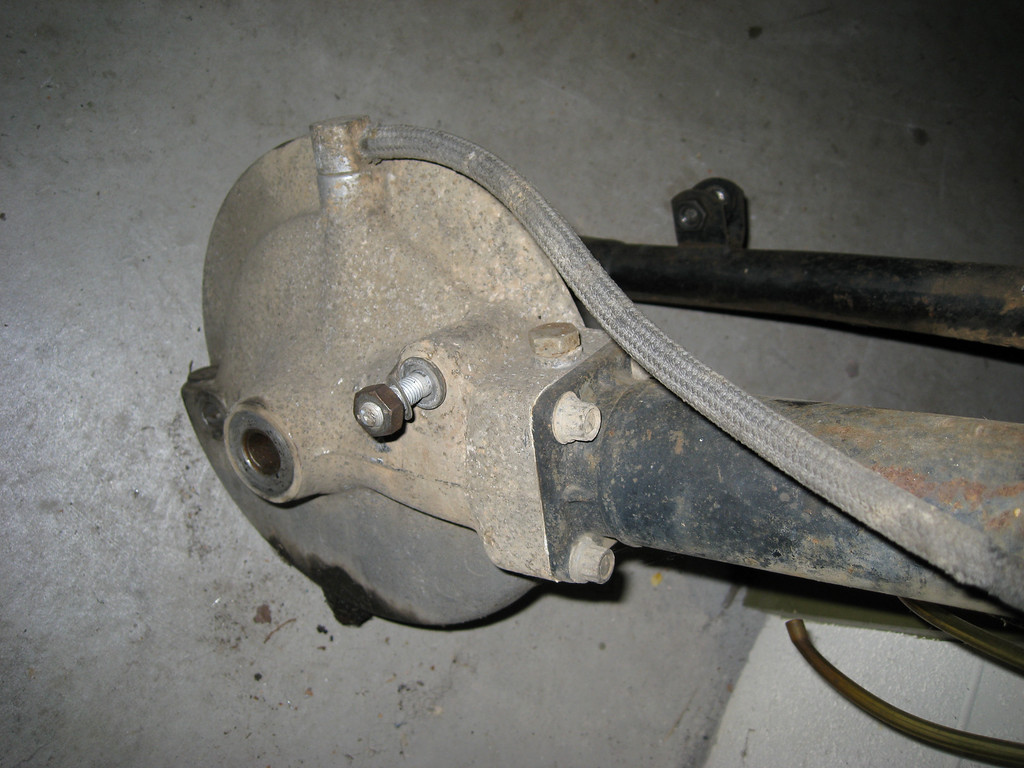

Early final drive on late swinging arm.

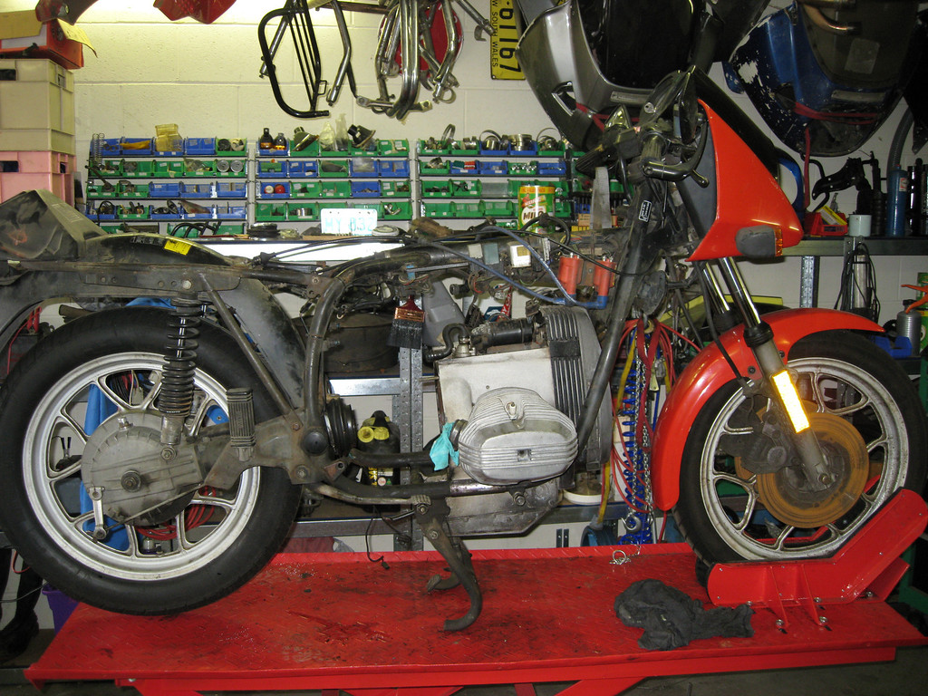

LS donates its R100 motor to make an R80RT an R100RT.
LS gets plain Jane R65 motor transplant.

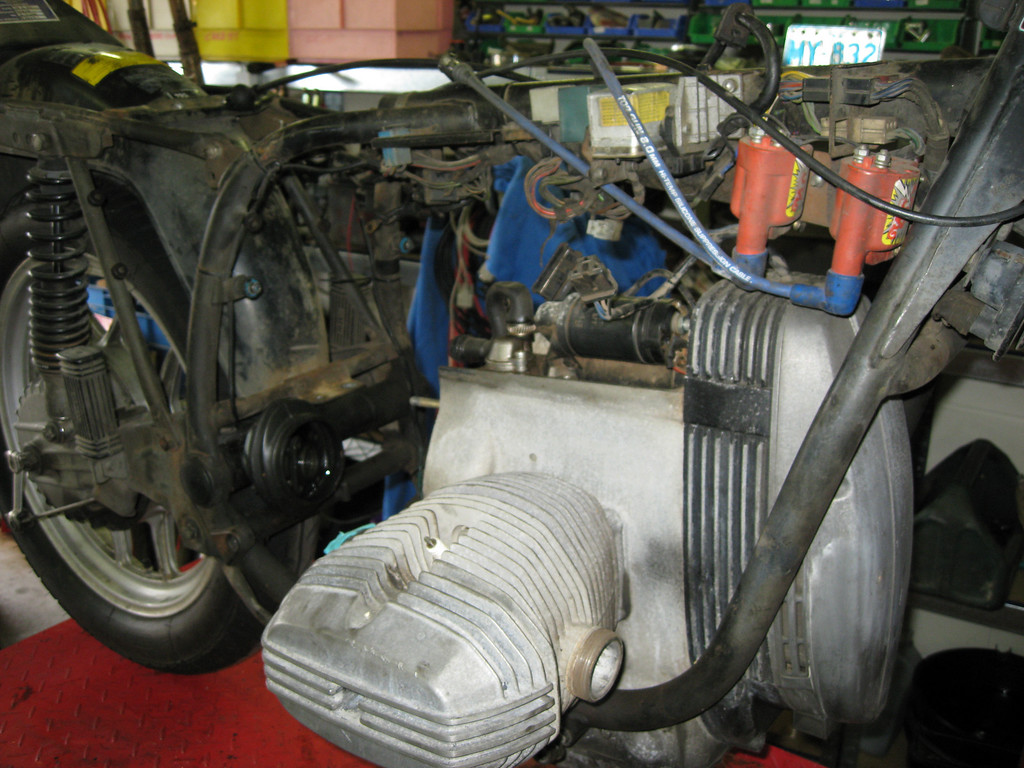

My fix for the horrible grey twin output coil problem.
