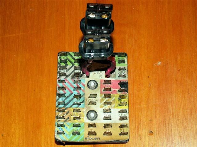

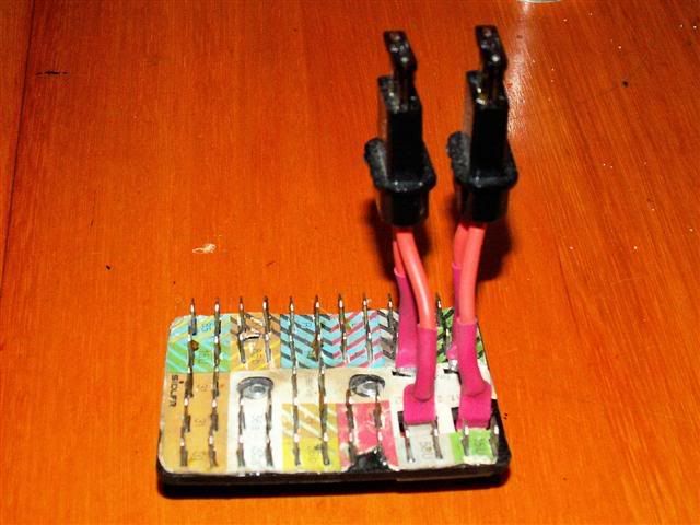

I've always been used to the European ceramic fuses, being standard on VW's. One regular bit of maintenance with them is to twist them in their holder whenever you are in their area, or at least a couple times a year. This will help to clean and wipe a new contact surface area, spraying with CRC will help clean and protect as well. You will also feel if the contacts are weakening or have heat damage due to poor contact. These fuses also age and require replacing every few years, just compare a brand newie and an old one if you don't believe me!! That alone will save heaps of problems for just a few cents outlay.
Now, just because I am used to them doesn't mean I'm a fan, far from it (and the same with the 3AG glass fuses). However the newer blade fuses I am a fan of, they have a more secure mounting, easier to see if blown, and good contact area on the blade. My '86 R65 has easily accessible fuses under the seat so I put up with them, but my '76 R90/6 project bike had me determined I wasn't going to put up with the abominable position hidden at the back of the headlight shell. I wasn't concerned with accessing a blown fuse (I've never had one blow on any vehicle I've ever had!!), but doing my usual fuse maintenance would be a real pain. So with that philosophy in mind made up the blade fuse mounts in the pics. The holders are rated at 20 amps, but have 7.5A fuses in them. The wires are soldered direct to the old fuse contacts (and I have also soldered all the previously riveted contacts on the board), and are distanced off the board so are easilly accessed if needs be, not hidden way back like the original. The holders were originally sold as waterproof and come with sealed covers that go over the fuses, further protecting from dust etc., so will be slipped on when installed. It's a simple fix, in the Airhead tradition, so should aid with electrical reliability. I was going to fit a proper fuse block, but couldn't find anywhere suitable to mount it, so when I saw these, I knew they were the ones.
Bill.........................;-)

Bill, is that board part of your stock system, or did you add that too?  I'm not even sure at what I'm looking!   :(   I like the blade type fuses, and added one for my older bike, but for the R65 I just did what Rob did that started his troubles.  Wow, that makes me feel better.  No problems so far.

Ed, the circuit board you are looking at is the standard meeting place for all important electrical connections in all of the bigger airheads.  It resided inside the headlight shell.  What we see in Bills photos is the side that faced out when you opened the headlight.  The fuses were on the back side!!!
The R65 was the forerunner of "modern" circuit design, with the multi-pin socket connectors under the tank.
I am not sure when the rest of the line dumped this circuit board.
Joan
Actually Rob, the two fuses went across the board shown. Underneath the red heat shrink tubing in the same orientation as his new fuse holders.
Bill has done a very nice job of attaching to the same points the fuses clipped into.

« Reply #12 on: February 11, 2007, 02:04:09 AM »
Think Bill did a nice clean job on this. Hopefully, he had the board out to do it. Would have been tricky doing it in situ.
