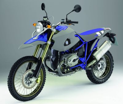

Now THIS...is a GS...
« Reply #12 on: February 08, 2007, 06:20:24 PM »
Wish I had the inseam, I might buy a lottery ticket!  ;D
