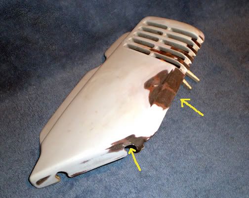

Arrows indicate locations of cracks. The exterior surface has been smoothed a bit. Some of the epoxy-flox remains in the bevel scratched along the crack's transit. Do not expect a simple butt joint to hold for more than a few hours of riding.
Lots of paint prep remains. The side panels appear to be replacements as they have a red primer typical of BMW parts. However, the mop used to apply the white paint produced a finish that is not worthy of the upcoming BMW Azur Blue Metallic paint. Wet sanding, wet sanding, wet sanding...

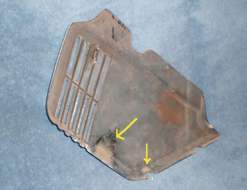

The interior requires a larger surface area of the epoxy-flox. This adds a great amount of strength to the repair. It is out of sight so there is no cosmetic flaw visible. Note the outline of where some adhesive tape was used to control the repair area.
