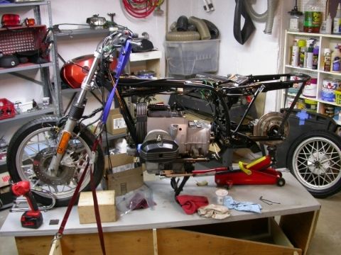

« Reply #60 on: March 20, 2014, 06:35:52 AM »
Further progress... Engine & tranny installed, since this picture was taken I've connected the final drive, installed the boot and torqued the swing arm pivots.
Not too far from being able to wheel it outside and fire it up!  :D

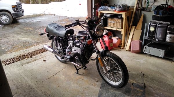

« Reply #61 on: March 28, 2014, 03:12:07 PM »
Today was a big day- I wheeled it out to the garage and started it!
The good news- it runs! And all the electricals work, the gen light goes out ~~1200RPM.
The bad news- it only idles, I give it any throttle and it just bogs.
Rebuilt carbs with new needle, needle jets, diaphragms, floats and float needles. Mixture screws 1/2 turn out.
Re: Winter project underway
« Reply #62 on: March 29, 2014, 08:46:54 AM »
After further review...
The left cylinder was only running intermittently. If I put my hand over the carb throat, it would bring it to life briefly. Turns out the idle jet is plugged, I swapped idle jets left-for-right and the problem moved to the right side. I soaked all the jets and blew them out as part of the rebuild, so now I'm going to buy new ones.

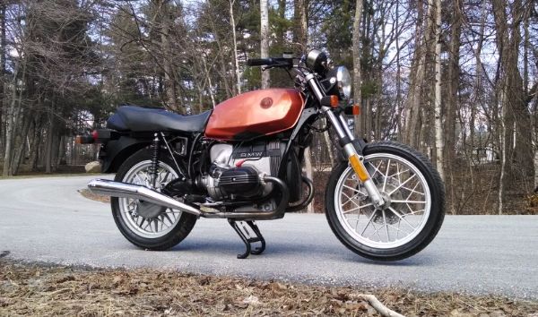

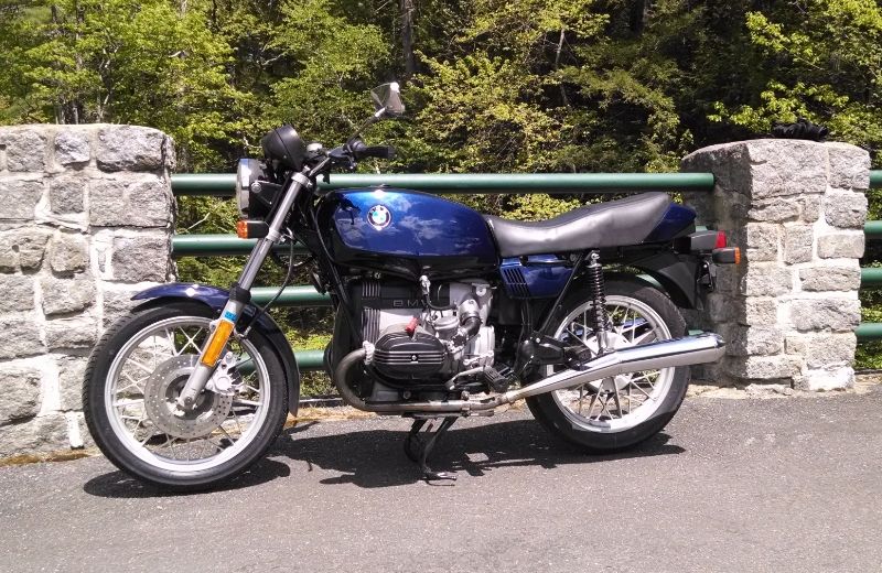

« Reply #66 on: May 21, 2014, 02:30:25 PM »
This project is complete! I'm real happy with the way it turned out, and it's a really fun ride.  :)
« Reply #67 on: May 21, 2014, 03:42:38 PM »
Liking the reflections of the clouds in the fuel tank. Beautiful bike.  [smiley=beer.gif]
« Reply #68 on: May 22, 2014, 04:31:44 AM »
Thanks Monte! And thanks to you and everyone here for all the help along the way. It's been a fun project.
