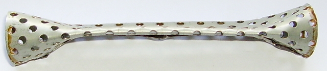

I know most of you will have seen this but... my modest contribution to oil filter research.
This filter had very good spot welds as I successfully turned it back into a tube and used it as an exhaust baffle.
« Last Edit: October 19, 2014, 11:33:05 AM by bhodgson »
