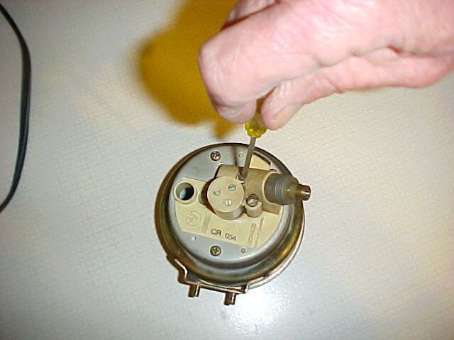

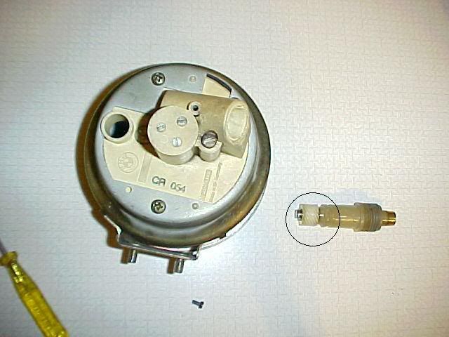

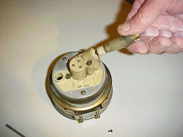

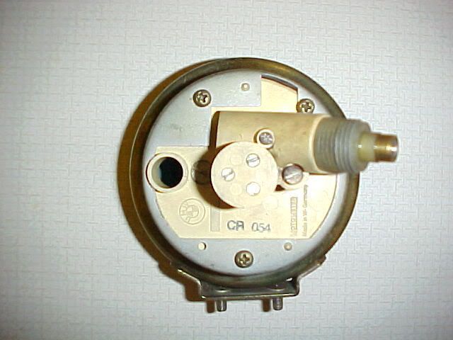

« Reply #6 on: November 28, 2006, 07:26:27 PM »
We did have my old speedo to experiment on, so we tried that before tackling the one on the bike.
I think you can do this without taking the speedometer off the bike.
[size=14]1.This is the back of the speedo.
2. Look for the small screw right in the middle - where the small circle meets the gear bracket. Unscrew this and remove.
3. Pull gear out of bracket.
4. Lubricate the gear.  I think we used vasoline - or some lightweight grease.
5. Put back together and hope it's better![/size]
You can inspect the gear while it's out.  If it's completely worn out that might be your problem.  Don't know if you can just buy a new gear.  We also found this site... http://www.speedometer.com/
Don't have any experience with these guys, but they did answer our email with helpful info.
Good Luck!

Aïda,
We found the gear assembly on our '80 speedo was the culprit.  The little plast bushings had frozen to the shaft and had worn into the nylon housing and let it wobble.  We took it apart, polished the shaft and wrapped quite a few wraps of teflon tape around the little bushings to hold them in the housing.  After doing this it worked very smoothly.
