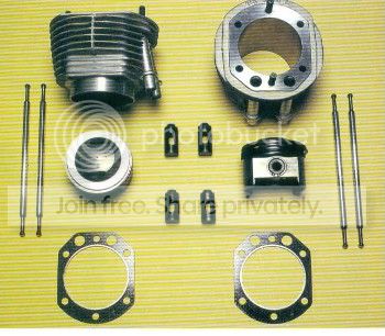

Hello all
Hope you're all well rested.
Has anyone, or know of anyone who's, fit the Michel 850 kit to the R65?
It's supposed to boost the R65 BHP to 70+ from 50.
I know some may think why, but a friend and I were talking and have both decided to build a race bike to take to Bonneville before we're 40 (10 yrs to get there).
I've been looking at lots of classic British bikes to do as a racer, but couldn't decide on one i liked or wanted to do that hadn't been done to death.
As the R65 is the loveliest bike i've ridden and the one i'm contempt with, most other bikes last about 3 - 4 months before i'm bored, but the R65 is different i've had it 18monhs now (only done 2500 miles on it) but i love it all the same!!
Anyway you may have guessed i'm going to build an R65 racer, not just for bonneville, i like track racing too, it'll be a bit of an all rounder - tracks, hillclimbs, and Bonneville!!
I'm not too up on tuning engines, but i'll be looking into/ working on drilling conrods, fly wheels etc.
Really the bike will only have the engine and frame of an R65, the other parts will be adapted to fit, R6 upside down forks, BMW adventure wheels & final drive etc
It's all in the imagination stages so far, i might go so far as drawings but i'm no good a that!!
Well if anyone has any advice on the Michel setup i'd appreciate some info.
Many thanks
Elliott

MR.E
Re: 850cc - R65 upgrade - Bonneville racer
« Reply #2 on: December 27, 2012, 10:00:48 AM »
thanks
I post as GS-Ell on there.
I found this thread the other day, i've emailed Michel's website but no answer as yet.
I know the basic idea, R80 piston and the rest can be run on R65 gear.
Thanks

MR.E
« Reply #6 on: January 01, 2013, 05:18:01 AM »
I can't seem to find it as a kit anywhere.
I've emailed Michel, but have had nothing back.
The idea is to bore the R65, as it loves to rev, rather than a torquey r80/100.
I've looked into the upgrade, a company i know can bore it and use a nikaseal(??) shim
I need to cut down the length of the bigger piston to match the R65's but am confident in doing it all.
Elliott
