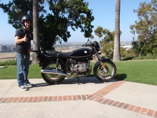

Hey guys,
I live in Los Angeles and just got a 1983 r65 with 27,000 miles on the odometer.  It looks pretty good but it has some rust.  I am really excited to fix it up and make it all nice and shiny!
I am setting up this thread in order to record my build/restoration progress.  So far, I have just swapped the old emblems for new ones and took off that ugly luggage rack.
Problems so far - have to hold throttle even with choke on to warm up bike otherwise it will die.
-Gets stuck in Neutral sometimes and I have to release clutch and squeeze again then it moves.
-Planning on repainting engine covers and crash bars.
Any suggestions on cleaning supplies or anything else? - so far I ordered some simichrome and I have some simple rust remover (that hasn't worked so well) from Pep Boys
Cheers to a fun project!

That "ugly rear rack" is worth $100 or more.  NLA and very strong.
Your idling problem is probably dirty carburetors.  Having to rebuild them is very common, not too expensive, and pretty easy to do.
Congratulations, and FINALLY, someone that knows how to size pictures to fit!!!  ;D

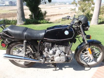

Welcome to the herd, Daman.
Your R65 looks pretty tight. And Rob is correct about that "ugly rack"; list it within the Trading Post section and you'll likely sell it fast, if you are so inclined. It is a rare bit of BMW kit.

Nice jugs and mugs ya got there [smiley=beer.gif]
