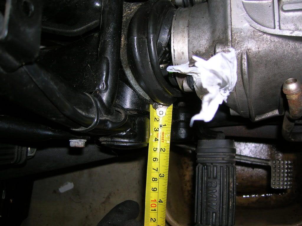

Take a measurement of the inside space, or gap between the frame tube and swingarm tube to help assure yourself that you have things
back close to being centered upon reassembly. I recommend that you might use something a bit more accurate than a tape measure, but you get the idea.

shaft and bevel box off as is gearbox.
but i did forget to measure the threads etc! humm anyway sure i can get around it
