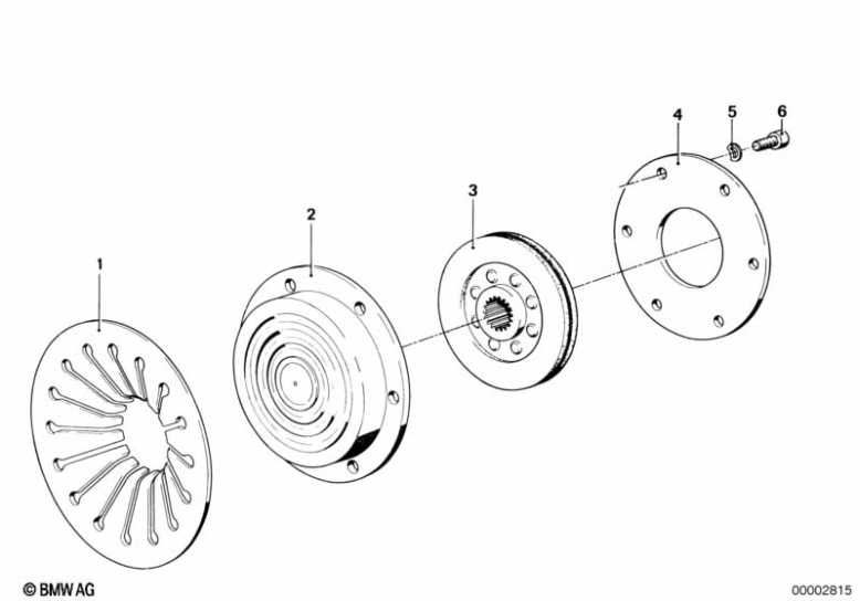

Thanks John. Im very familiar with motobins, I'v gotten quit a lot of stuff from them over the years.
Just to be 100% sure before I start ripping out seals.
This is the clutch pushrod oil seal right?
https://photos.app.goo.gl/rv5EzZDNjZFp3xLk8
No. 15 in this blowup.
And, I cant seem to get the clutch assmebly off. All 6 bolts are out, I tryed heating it a little, and give af few gental taps with a hammer, but it wont budge.

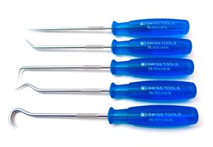

Yes this is it, after I wiped it down I found a tear in the lip and I want to replace it. How do I best go about getting it out, can I get it out with a pick tool?
I have a set of these:
'83 BMW R65
Re: Bolts for clutch removal tool
« Reply #24 on: February 05, 2019, 05:10:31 PM »
Most people use a suitably sized screw driver and (maybe) a rubber mallet to remove small seals. Learger seals are usually easily removed by running self tapping screws partially in around the periphery and then using a screwdriver or a claw hammer to lever them out using the screw heads.
To put seals in, a socket of about the same size and a rubber mallet usually works. But for big seals (for example the rear main seal) a proper tool is advised.
If you are a person that must have the "correct" tool, these are good examples of ways to spend money:
 https://www.ebay.com.au/itm/10-Pcs-Bearing-Race-Seal-Driver-Installer-Set-Remover-Automotive/301768118014?hash=item4642c80efe:g:6lIAAOSwc49Y6HQy:rk:1:pf:0
https://www.ebay.com.au/itm/12-Rubber-Seal-Puller-Remover-Oil-Grease-O-Ring-Grommet-Removal-Pulling-Hook/263570240885?epid=2218287641&hash=item3d5e02b575:rk:4:pf:0
PS - for my sins I own both of the above.
This one however is money well spent:
https://www.cycleworks.net/index.php?main_page=product_info&products_id=18
It will also set the big seal in the final drive.
