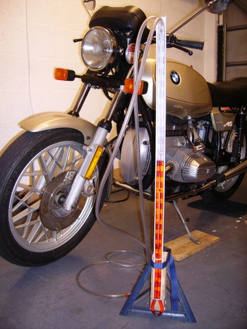

« Reply #7 on: October 01, 2018, 06:35:44 AM »
Have you considered making a vacuum balancer. Just a length of plastic tube, some ATF or other thin liquid and a means of mounting it.
