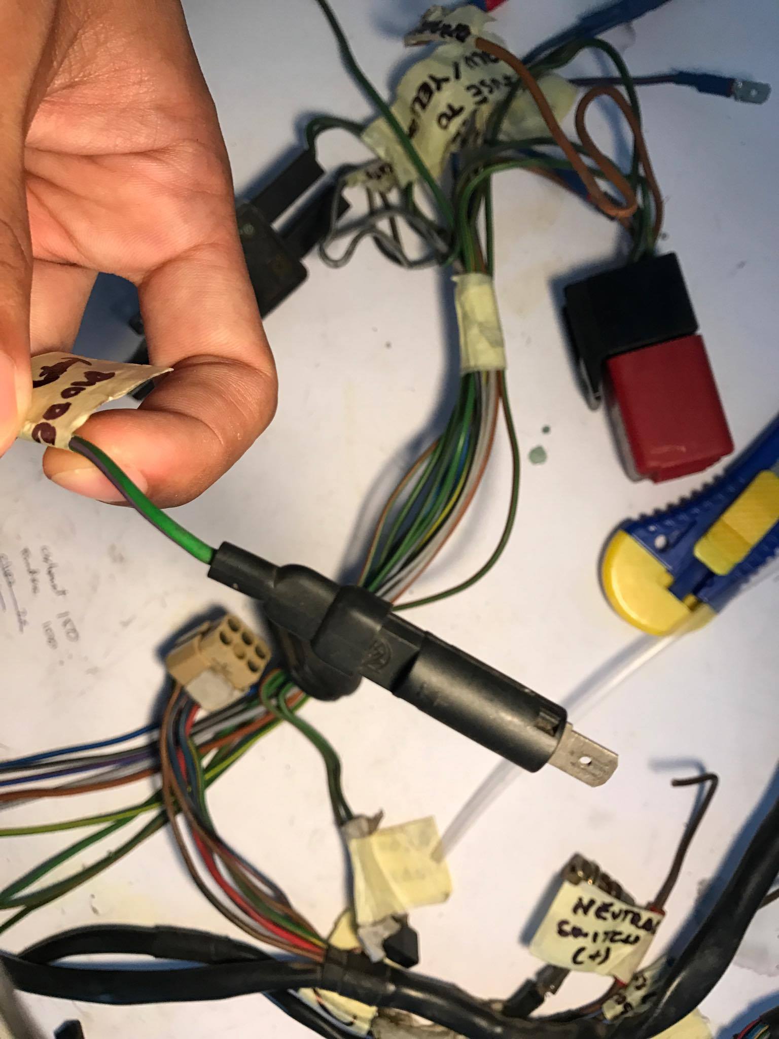

Re: Wiring Harness Question - 1979 R65 - US Spec
« Reply #17 on: January 02, 2018, 04:54:37 PM »
Just to make sure, your bike does not have the factory 4-way flashers, does it?
That diode looks like the one that comes with it.  It would have been located in the fuse/relay box under the right-hand side cover.

Thanks Rob. Got this sorted. Yes I have the 4 way flashers.
I also got the RPM working now with the same signal wire except, having to add a capacitor 100nF to the black rpm signal line and grounded resistor 150Kohms tapped after the capacitor to the same rpm signal wire.
