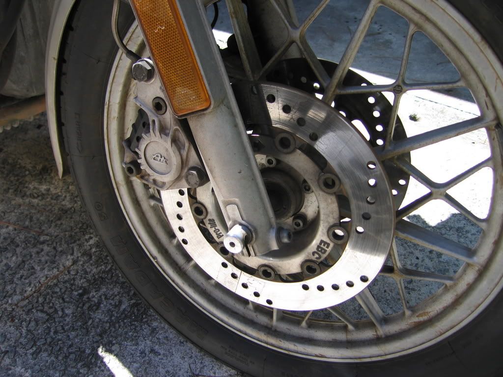

OK Here are a pic or two.  The first showes the rotors on the bike.  The rivits run outside in and the wave washers (springs) are on the inside held by a washer and then back side of the rivit.  The are a loose fit on the inner hub allowing the rotor to "float" This is the cause of the chatter when not under braking.

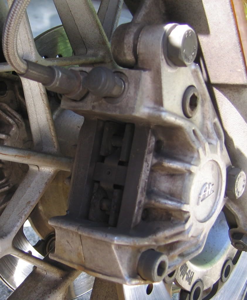

The second pic shows the back side of the caliper and the space I cut of the top of the pads so that ATE "Wheel Spring" will fit with the pad.  One thing I really like about the ATE brake is that when the metal surface of the pad is about to touch the spring - the brakes need to be replaced (easy wear indicator).  And yes my brake pads are about worn out (although they don't feel it).  I have replacement pads on my bench ready to be cut.
You can see the "wheel spring" between the pads.
