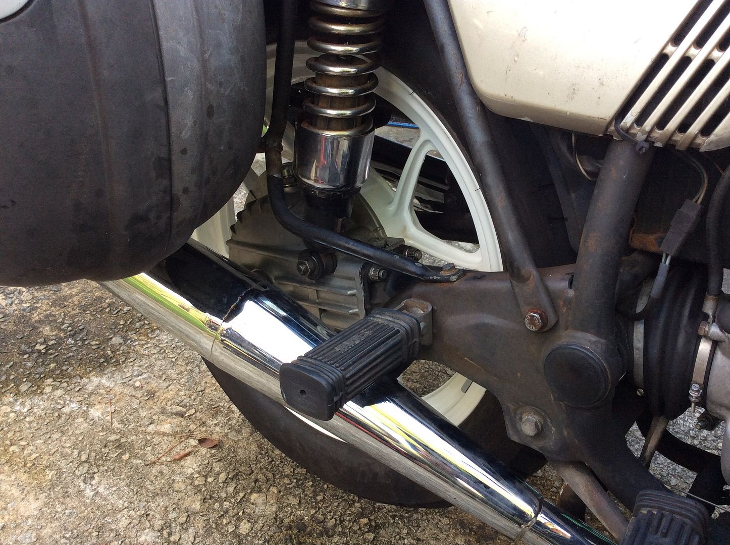

Hi Guys,
I know its been a while...
BUT I just did something that somebody else might want to do.
The splines were worn out on my snowflake rear end both the wheel and the final drive so I bit the bullet and and went looking for LS parts to sort of match my K100RS front end I have on the bike.
So I found a post 9/80 square rear end 32/9 off of fleabay that looked like it had pretty good splines.  I found a LS rear wheel with good splines over at Nathans (Boxerworks).
The wheel went to Metro wheel Marietta GA for straightening and powder-coat (White).  Then to BMW of Atlanta to clean the bearings and to get properly shimmed for the preload plus transferring my Michelin Pilot Activ 4.00.  I scored some Ferodo brake pads off fleabay again and the tension springs from BMW of Atlanta.  And I found a machine shop to turn the rear axle shoulder back about 22mm to allow for the wider LS wheel. (In truth it only needed about 18mm).
Today its all done and first test ride all is smooth as glass with no vibrations or noises.  I spent a bunch of money on it but it all works...and no more tubes.  :D
Picture:
