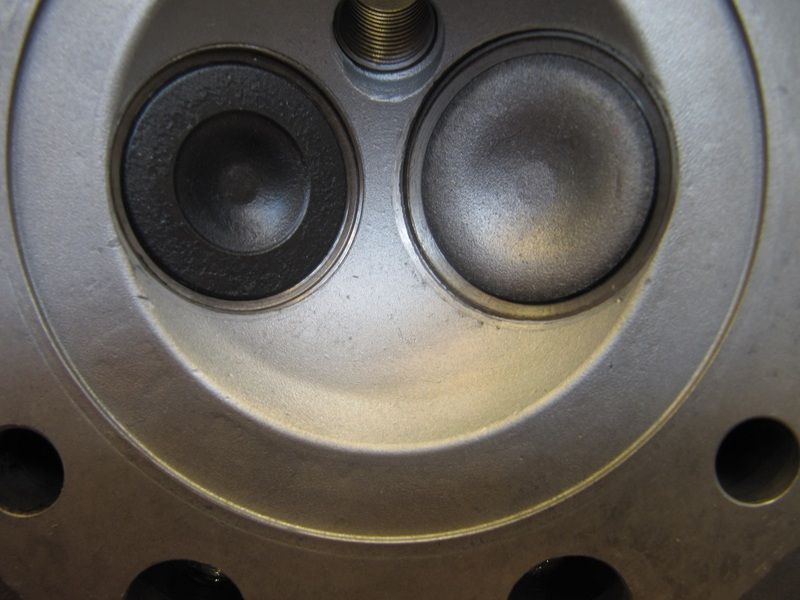

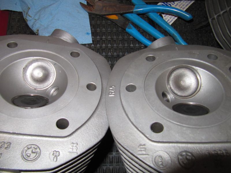

When I got the parts back from the machine shop, I didn't really compare what one head looked like vs the other one.  I looked at them, and they were shiny and clean and pretty.  lol
So yesterday I took the right side head off, put it on the bench, then took the left side off and set it next to the other one. Then I got to looking at them.   Hmmmm.....
This is what they look like side by side:
Problem head is on the right.  You can see where the intake is seated lower that than the one on the left.

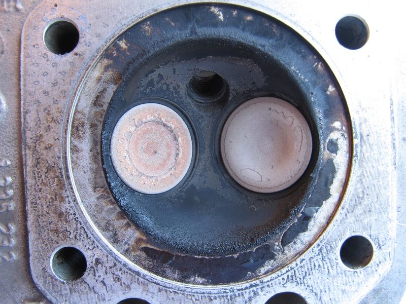

But.  This is what it looked like before I sent  it off:
And now:  I cannot tell if the recess is any deeper.

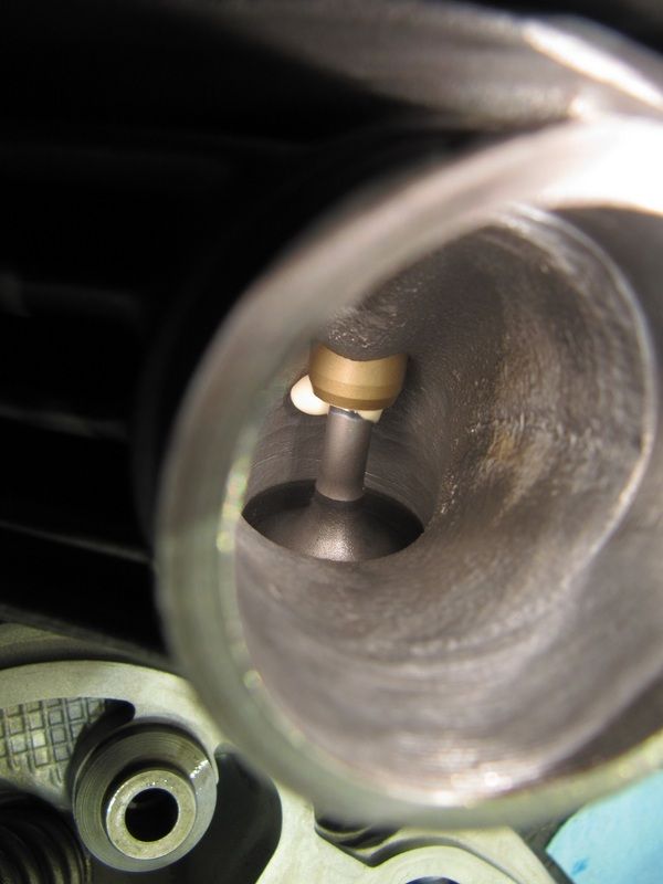

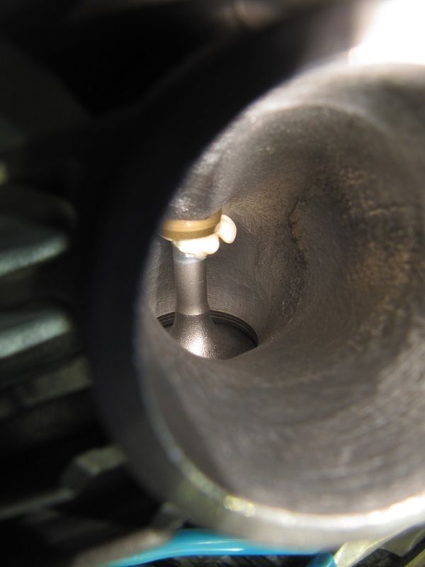

Now we look inside:
Left side:
Right side:
You can clearly see the valve guide on the left head is pushed further onto the valve stem than the one on the right.
And measuring the intake spring heights, the problem (right side) head is roughly 1/8" taller than the left side.
I thought this might be related to the unleaded fuel, but from what I can tell, its only a problem on the exhaust side and normally not on the pre-1979 bikes.  But I don't know.  The bike was having some leak down and compression issues on both sides, which is why I tore it apart int he first place.  So, the question now is, can it be fixed?
Would pushing that valve guide further onto the valve stem solve the problem? I think maybe not, as the guide is just a sleeve and has nothing to do with the length of the stem. And the valve cannot be pushed any further in as then it won't seat properly. Am I SOL and I should start shopping for a new right side head?

Re: Valve adjustment problem
« Reply #20 on: March 19, 2015, 01:26:36 AM »
I really do not know what to say.
When you give advice it is necessary to assume that people, especially people you pay money to, have done the right thing.
That anyone pretending to lay claim to being a mechanic or an automotive machinist gave that head back to you in that condition beggars belief.
They are thieves, nothing more or less and morons to boot. Had you been able, in your own ignorance, to have achieved tappet clearance you would have ridden on that engine and it would have self destructed.
Bye the way, you do not have "valve seat recession", Obviously I cannot see the seating face of the seat, but what I can see looks fine, they have not receded. What you do have is a valve that was worn beyond further service that has been refaced and as a result of its reduced working diameter has been "pocketed" in the head.
Consult with a more knowledgeable and reputable firm and see if the seats are salvageable, (they probably are) then all you need buy is new valves and have the new and reputable firm properly seat the guide, K-line (or similar) them to correct clearance, and fit the new valves you buy for them.
On the other hand, if the seats are stuffed from the mishandling of the morons, then your best option is to buy a pair of decent heads on ebay and throw new valves into them after having the guides k-lined.
