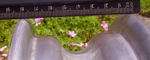

Re: LS Wheels
« Reply #3 on: August 26, 2014, 03:18:32 PM »
Snowflakes are without doubt WM series rims as the area between the centre drop well and the rim edge is flat.  MT series rims have a 5 Deg upward slope towards the rim edge.
I can't say categorically that LS wheels are MT type rims but there are some clues:
Anecdotal evidence from professional Tire fitter that they are suitable for tubeless tyres.
The attached service bulletin that describes a 4 deg upward slope towards the rim edge.
On balance I doubt they are officially Tubeless rims but they do seem to have some of the characteristics.
