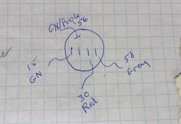

« Reply #3 on: June 10, 2014, 05:40:38 AM »
A little late I guess, but here's the sketch I made whilst taking mine apart:
tc80211
Re: '83 R65 ignition switch wiring - HELP!
« Reply #4 on: June 10, 2014, 07:55:34 AM »
Bingo! Thanks a million!
