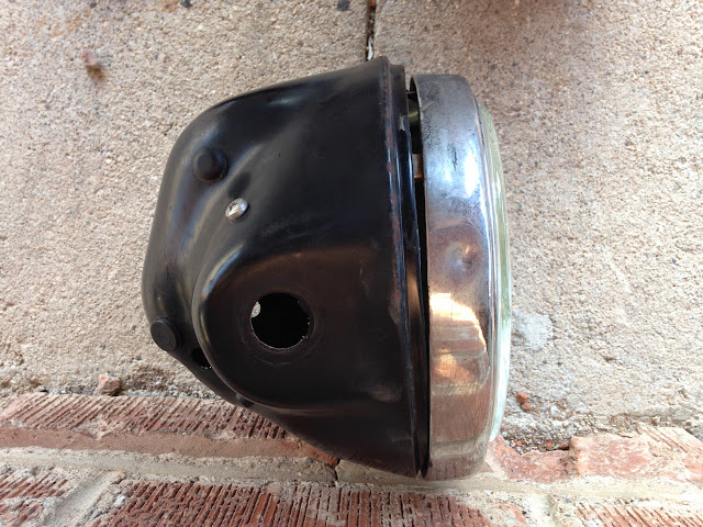

Guess how excited I was when my "new" headlight bucket arrived, fresh from Ebay? Then guess how disappointed I was when it didn't fit the headlight assembly!
After a few frustrating minutes of trying to force a headlight assembly onto a bucket that was obviously too large AND didn't have the same attachments, I decided to do some Google searching.
I searched for the number stamped into the glass of the Bosch headlight assembly... and much to my surprise, the results came back as a HARLEY DAVIDSON 7" headlight assembly. I didn't realize that Harley used Bosch assemblies and it's resemblance to the BMW r65 headlight assembly fooled me into thinking it was also for a BMW.
So now, if I want to use the larger 7" HD headlight, I have to find a HD headlight bucket, but I don't know anything about HD and what year or type of bike this headlight came from.
So I might put the headlight project on hold and just go buy another cheapie sealed beam light that fits the bucket that is on the bike now. Here is a photo of the HD headlight. Anyone recognize it and can point me in the direction of a make/model/year? If so, I can track down a used bucket!
« Last Edit: April 30, 2014, 11:55:15 AM by azcycle »

I've decided to put this particular project on hold. Instead, I purchased a halogen h4 conversion kit that fits the existing 5 3/4" bucket on the bike. So I get a brighter, halogen, replaceable bulb and can dump the sealed-beam junk.
