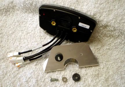

On the '81 R65, I did a cardboard mockup for the Vapor's mounting bracket and then used some on-hand aluminum for the final project.
Bracket goes under two handlebar caps bolts. Then the Vapor mounts with machine screws through rubber grommets for a cushioned attach.
