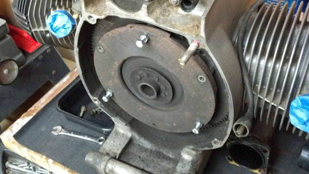

I'm trying to remove the clutch assembly. I bought some 6mmx1.0x45mm blots with nuts. Removed every other bolt and replaced with the longer ones:
I've now removed the last 3 original bolts, but I can back out the 3 long bolts and the plate doesn't budge! I've tried a rubber mallet, but no joy. Suggestions?
As always, thank you all for your patience with my never-ending stream of questions.  :)

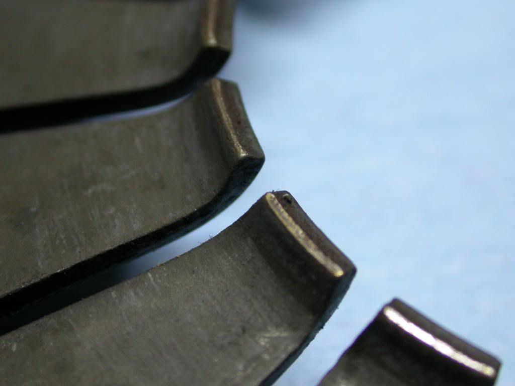

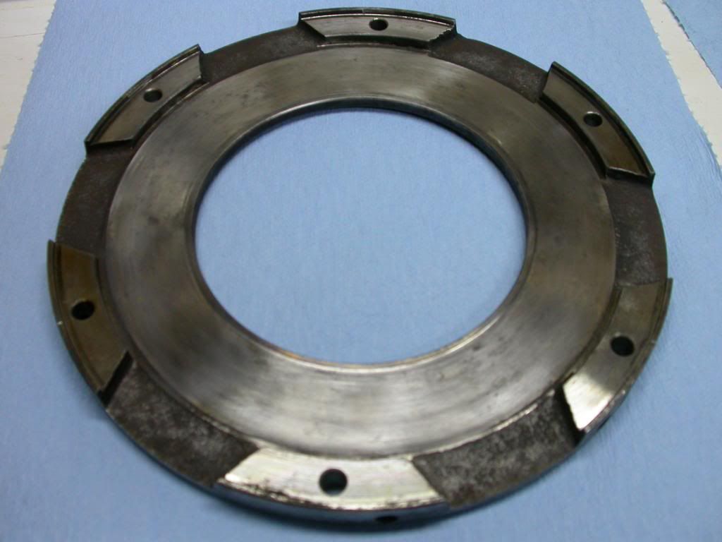

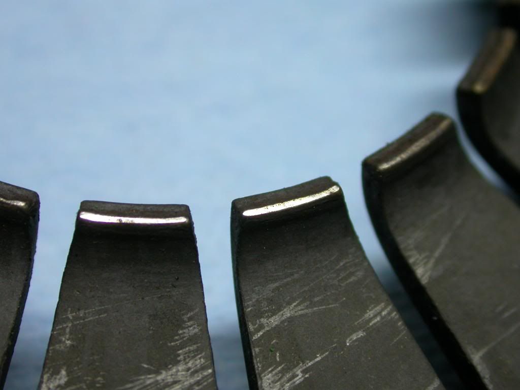

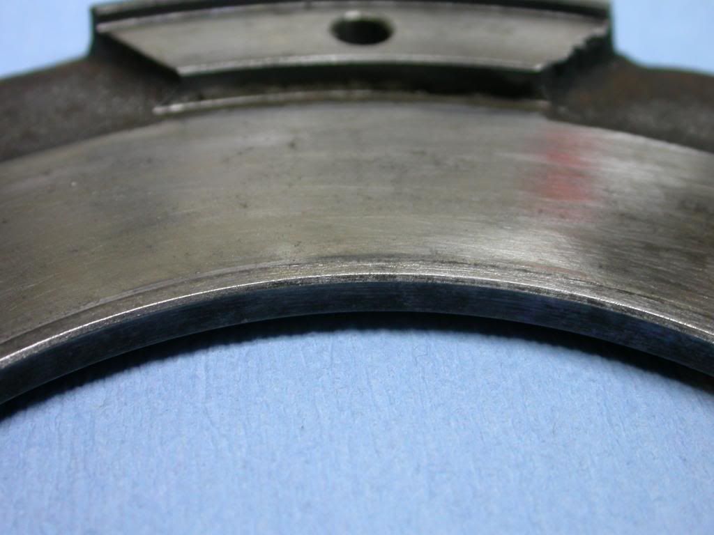

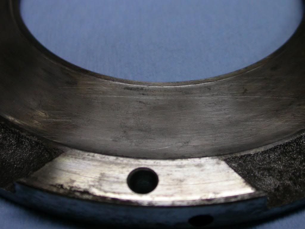

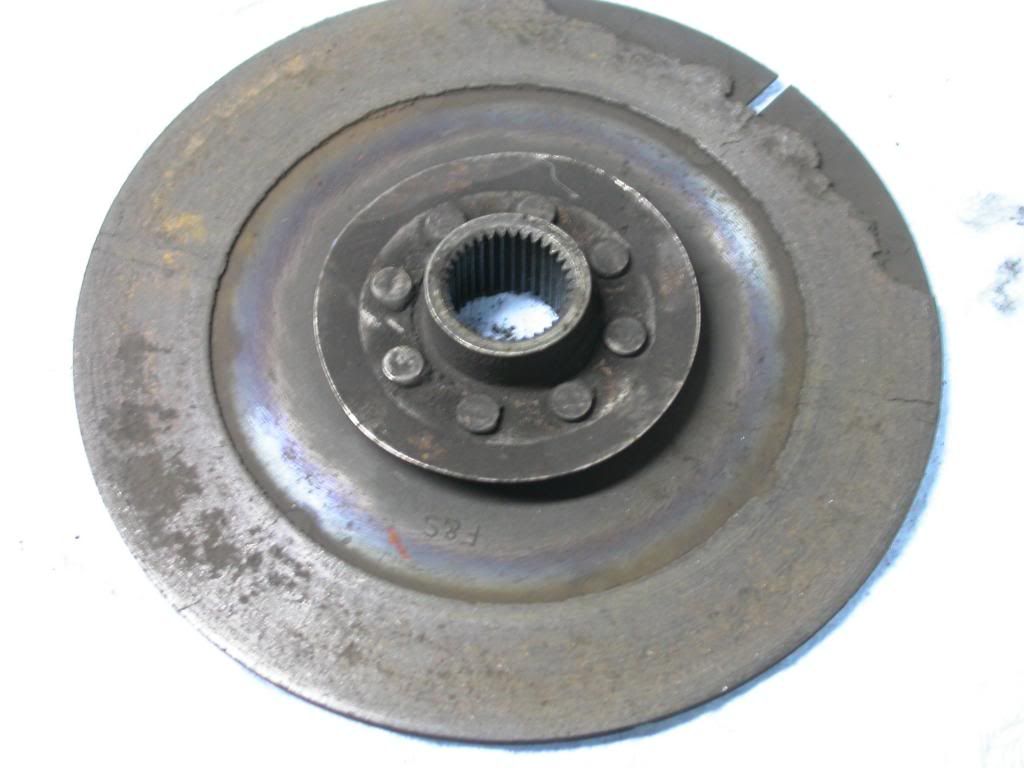

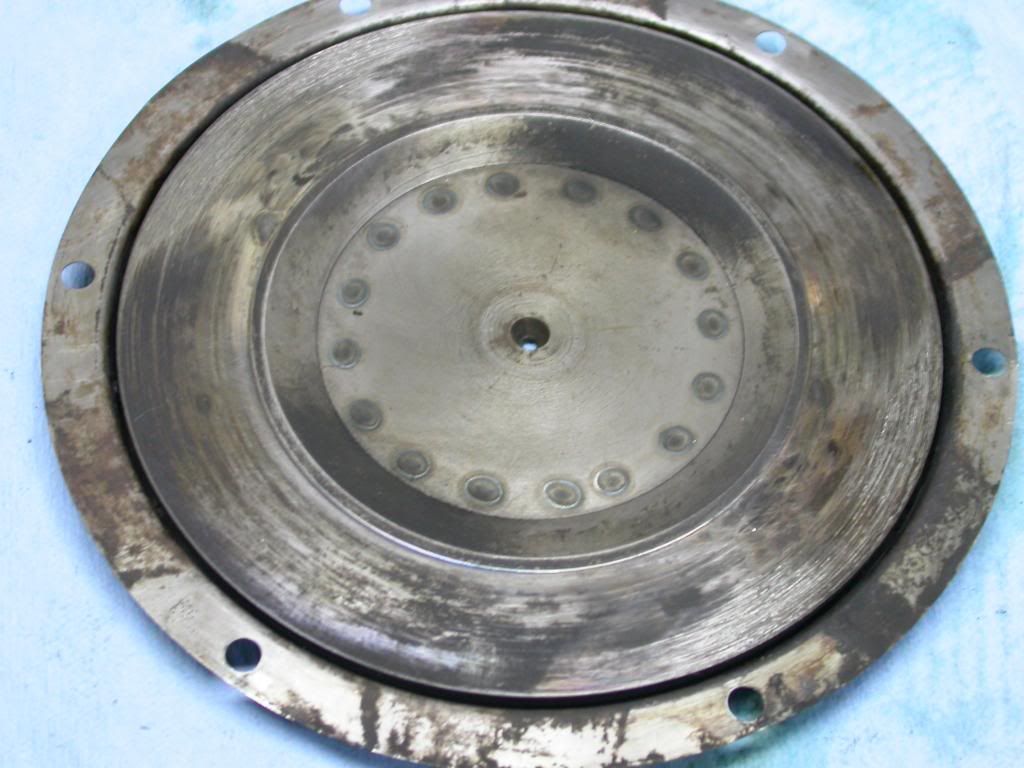

« Reply #4 on: December 29, 2013, 09:16:07 AM »
I got pics!
Diaphragm spring fingers:
Compression Ring
Just for laughs(or to make you cringe), the pressure plate and friction disc
The height of the diaphragm spring is about .61 by my measurements, which is at the top of the specs given in the Clymer manual(.5787-.6181)
So, I'm thinking I obviously need a friction disc and pressure plate, the diaphragm spring is ok, the compression ring…?

« Reply #5 on: December 31, 2013, 05:47:14 AM »
I am not familiar with the compression ring and how damaged yours is but this clutch replacement exercise has likely been a bit of an ordeal and the prospect of going back in to repair something you could have fixed on this occasion would lead me to the conclusion that 'if in doubt replace it'
My expertise is on cars and if I had to remove a transmission to replace the friction disc then I would want everything in tip top nick before I put it back together.
Peace of mind would carry the day
