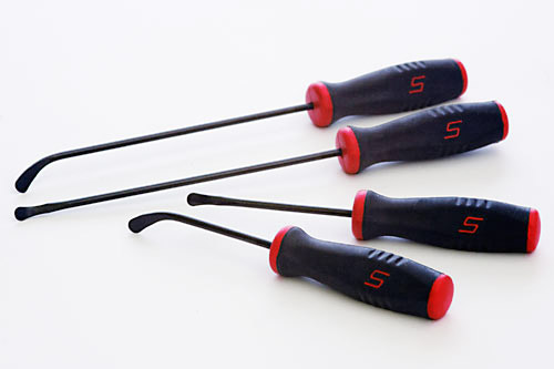

There are actual seal puller tools that do the job quite nicely, and usualy you can use the seal over again. Im sure you could walk out of Harbor Freight with something that will work, like this http://www.harborfreight.com/seal-puller-35556.html
Seal removal should be the easy part.
Same shape as mine, but mine is not HF.
