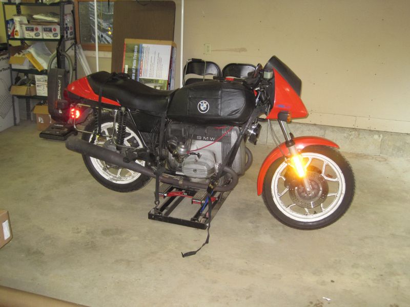

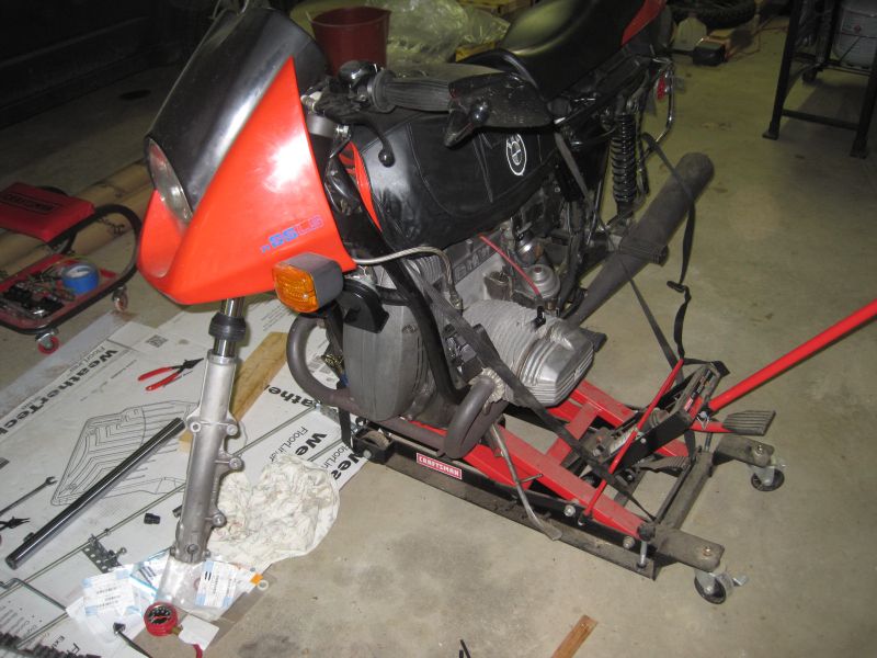

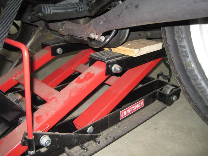

You *can* lift the R65 with such a lift as long as you go slow and use a little bit of common sense.   I do end up with one of the lifting pads on the engine sump.  The other lifting pad pushes up against the frame at the centerstand mount, by inserting a small piece of ~5/8" plywood in between the (2) spring hook points on the centerstand.

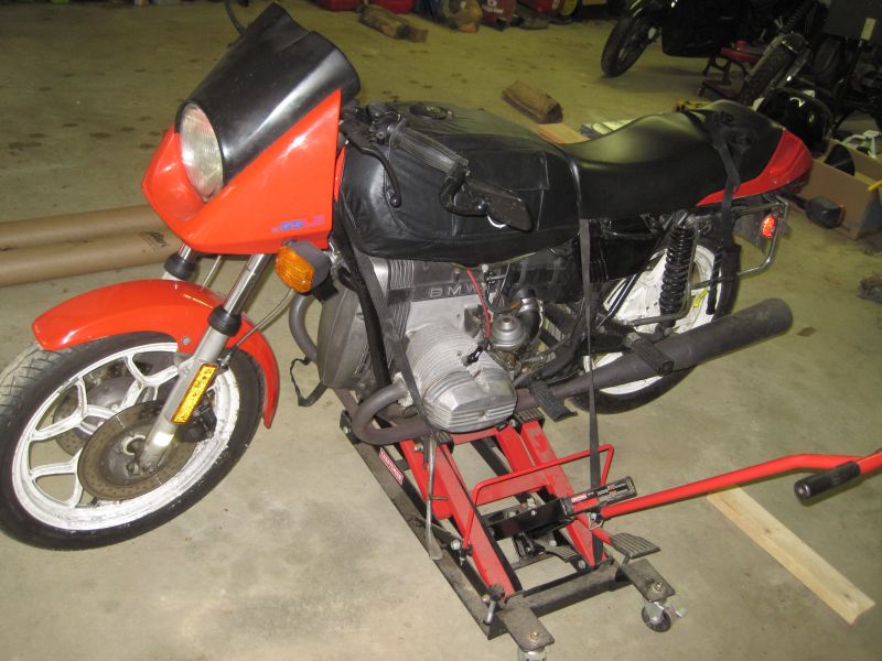

You *DO* want to secure the bike (or anything that you put on these lifts) with a ratcheting tie-down or two once you've got it up at the right height.   As long as one is aware that it isn't as stable as the bike is when sitting on the ground, you can still do alot of work - I pulled off the wheels and forks and reinstalled everything afterwards with the bike on this stand just this week.
Piece of wood inserted here allows good weight sharing and good balance:
As long as you don't work like an idiot, you can get alot done-
