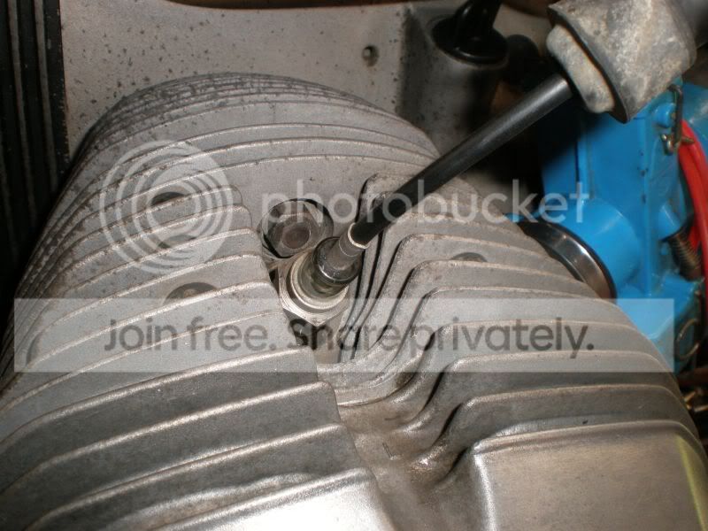

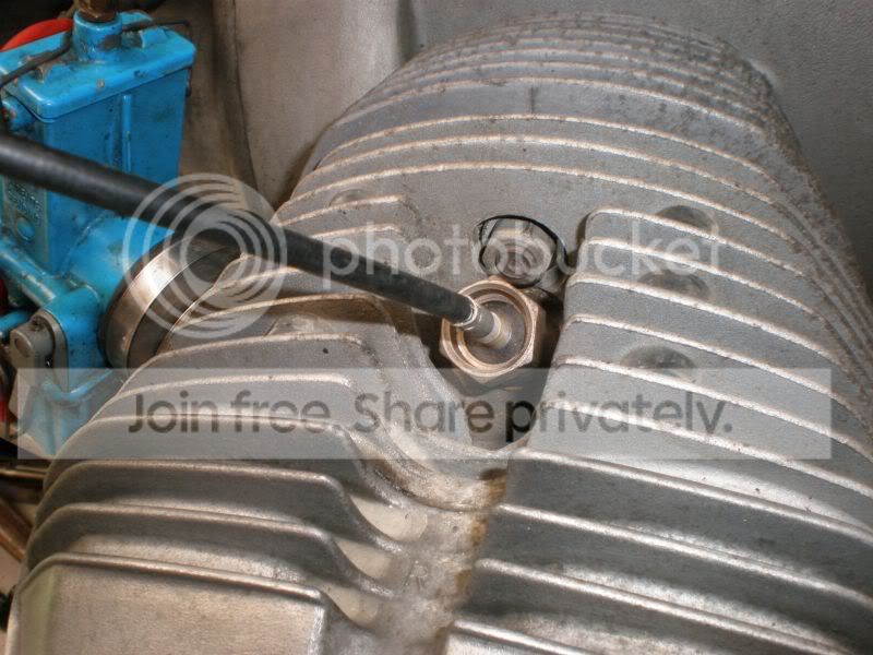

I have two - one for this side...
And one for this side...
