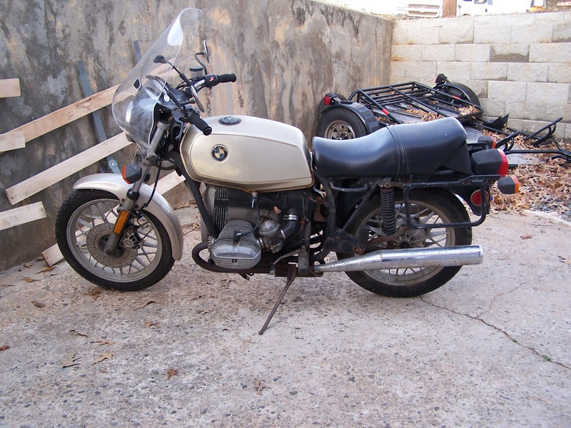

I have posted in a few other areas and topic but figure starting a thread for the bike is appropriate.
"Katrina" was purchased inexpensively from an Atlanta company that buys trade ins at a Ducati dealership. Great price, nice guys, "it runs" was the good part.

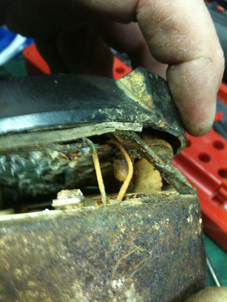

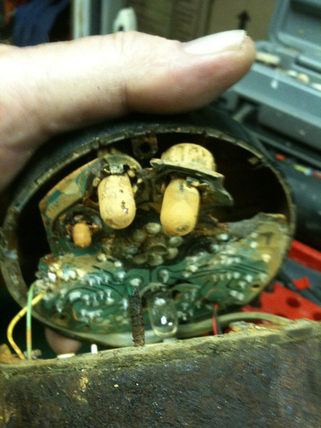

* Dash & gauges removed - Water line visible in gauges?!  They're trashed!

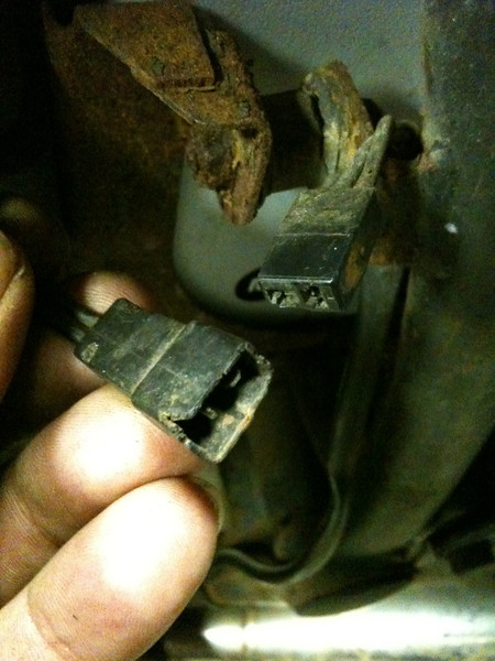

* Wiring. Maybe dirt-GS bobbering it. What are these connectors for?:
Also any pinouts for the main circular dash wiring connector based on pin#s?
I have a spare relay spot and a few connector blocks under the tank with plugs in them. What are they for?

Hi Marty, There are many members with more mechanical experience and knowledge than I have. That being said if I were in your shoes I would see if any state laws concerning disclosure on flooded vehicles were violated by the dealer. Get your money back. If that is not possible, I think "Katrina" needs to be completely disassembled to either restore or sell off the parts. I just imagine that there is just too much hidden damage. That is my humble opinion, maybe I'm being too pessimistic? In any case welcome to the forum and good luck [smiley=bmw_smiley.gif]D2

A brave man taking on a bike in that condition... I hope it was really really cheap.
That's normal. Spare connections are probably used on Authority bikes.

Im going to be the odd one out. i dont think she looks too bad. By R65 looked a little like that after it had been stored badly in a garage for a few years! The dash on mine leaks etc i keep thinking about buying a digital one.... maybe oneday.
Apart from that clean her up lick of paint on the frame and your ready to rock.
If she runs thats the main thing.
