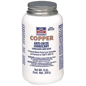

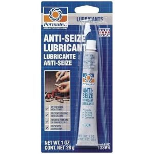

And take care not to fasten things down too tight, as many of these fasteners are steel into alloy, and the alloy threads are easily stripped.  This includes the spark plugs.
Also, regarding the spark plugs (and exhaust nuts - but you are not there yet), you will want to employ some sort of anti-seize paste.
I use the standard Permatex anti-seize compound.
But many prefer the copper-based:
The copper is only available in 8 & 16 oz bottles.
Available at any auto parts store.
