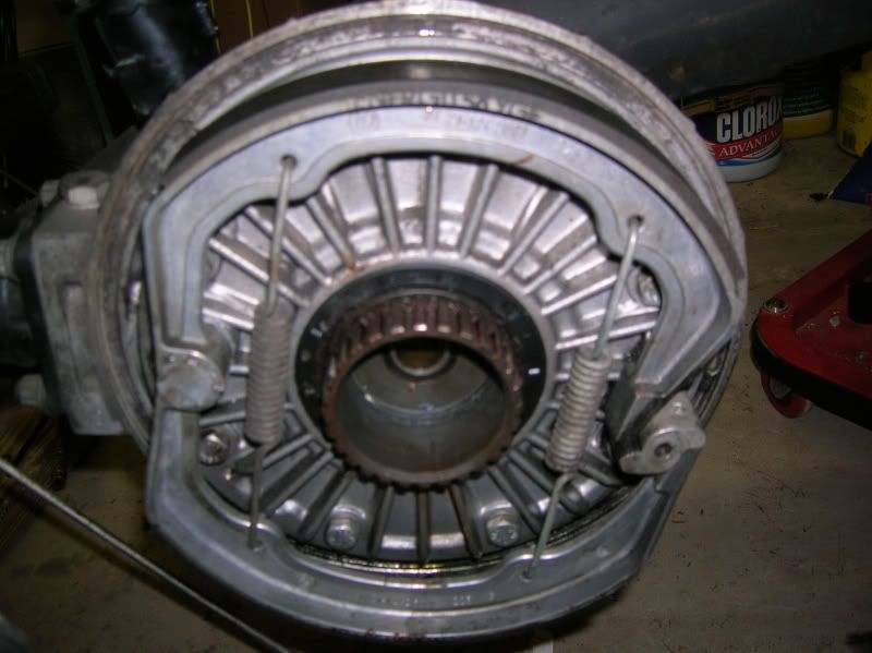

I know the R65 and the LS have different brake shoe sizes, is there any difference in the rear drives themselves?  I put a reman R65 rear drive into an LS bike and changed the R65 shoes to LS shoes, but still can't adjust enough to engage the shoes in the drum.  No noise, rides great, just no rear brake.  I've even disassembled, changed the shoes back to the used ones that worked in the old drive, but still no joy.
I understand the rear drives are interchangeable, so is there something else I've missed that's needed to fit?  Next step is to disassemble again and compare/measure new and old, just wanted to ask first to be sure I have whatever's needed to fix the problem.

can you post pics of your shoes?
The LS shoes are a bit larger and are shaped a little bit differently where they contact the brake cam at the back.   Possibly you've got the shoes swapped top/bottom?

I'll take a picture when I disassemble it.  Didn't want to do that until I knew better what might be wrong.  Is it even possible to swap them top/bottom?  It's not possible to put them in wrong side out, and if they're both the correct side out they have to be right top/bottom or they won't fit on the cam.  Right?
As long as I know the drives are the same, LS and non-LS, then my problem is with the shoes, either buying the wrong ones (they said they were LS) or assembling them incorrectly.  When it's apart again I'll compare the shoes I bought with the old ones.  Probably me, that's usually the problem.

The arm that the brake rod attaches t on the final drive, is supposed to be installed so the small dot on the brake cam, looks like a centerpunch mark, is centered in the gap between the two ears that the bolt clamps down on .

Yeah, that's not it.  I can manipulate the brake lever by hand even past the threaded section of the rod and it still doesn't engage.   There's something else wrong, I just need to take it apart again and see what.
