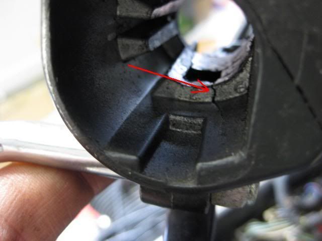

So back to the high bars for now, one problem I discovered in the process is that the left side control assembly is cracked, I assume because someone over tightened:
it seemed to go back on OK, and I was careful not to over tighten, but I better start looking out for a replacement, new ones are rather expensive

Did you by chance have a small triangular shaped in cross section piece of metal about 1 cm long when you removed the control housing?
It keeps you from cracking the cast metal housing when you tighten up the retaining screws .
Commonly referred to as a wedge, not available from BMW anymore .

The other thing that can crack the control assemblies is trying to force them onto 7/8" bars which are slightly over size at 22.23 mm.  Your new bars will be 22mm but what size were the old ones.
 :), That would be this guy:
It fell out on the floor and I scratched my head as to what the hell it was for but eventually figured it out, though I was still wondering if it was meant to be there or something someone had added to work around any looseness caused by the crack, so good to know it is meant to be there.
I didn't notice or think to look of there was one on the right side assembly?
Yes just measured the new bars and they are 22 exactly, funnily enough the old ones are reassuring up at 21.5,  but 30 year old bike, who knows what other bars may have been on it
