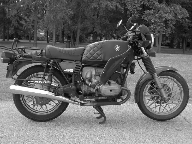

I just saw this picture that Rob Valdez posted which I think is his bike with a single seat and rack.
Can you (Rob) or anyone else give me info on what the seat/rack is off and where to get it?

link to the picture of my bike.
Not a problem.  I bought the seat & rack from S. Meyer in Germany.  They gladly ship worldwide, at fair prices (In my opinion.).
This is their list of seats: http://www.meyer-bikes.com/ersatz3.php?cat=32
And this is what I bought: http://www.meyer-bikes.com/ersatz_detail.php?id=2005
It is made for the R65&R80G/S.  There was a R65G/S for the European market.
Since ours is not a G/S, there are major differences in the subframe.
The rack has to have a few bits cut off, and then welded onto a sacrificial sub-frame.
If you click on the WWW at the bottom of my post, it will take you to my photo website.
[size=12]Here is the link![/size]
From there, look for "My R65 Stuff", and then go to "Accessories".  You should find a gallery with lots of pictures of the process, including one of my bike being lifted into the bed of a truck by the rack and handlebars.  Good welding, I would say!  (I didn't do it!)
The biggest problem with this solo seat is the hinges.  It doesn't really jive with our sub-frame.  I was able to buy a special BMW hinge that fits the forward-right-hand mounting hole on the '81-'84 bikes (a tapered fastener), but I'll be damned if I can't find it on the microfiche.  I'll have to wait until I get home and find the part #.   With that, and making up some kind of rear hinge (the pin is already on the sub-frame), and adding a latch pin, one should be able to make up a nicely pivoting seat.

Nuther view:
