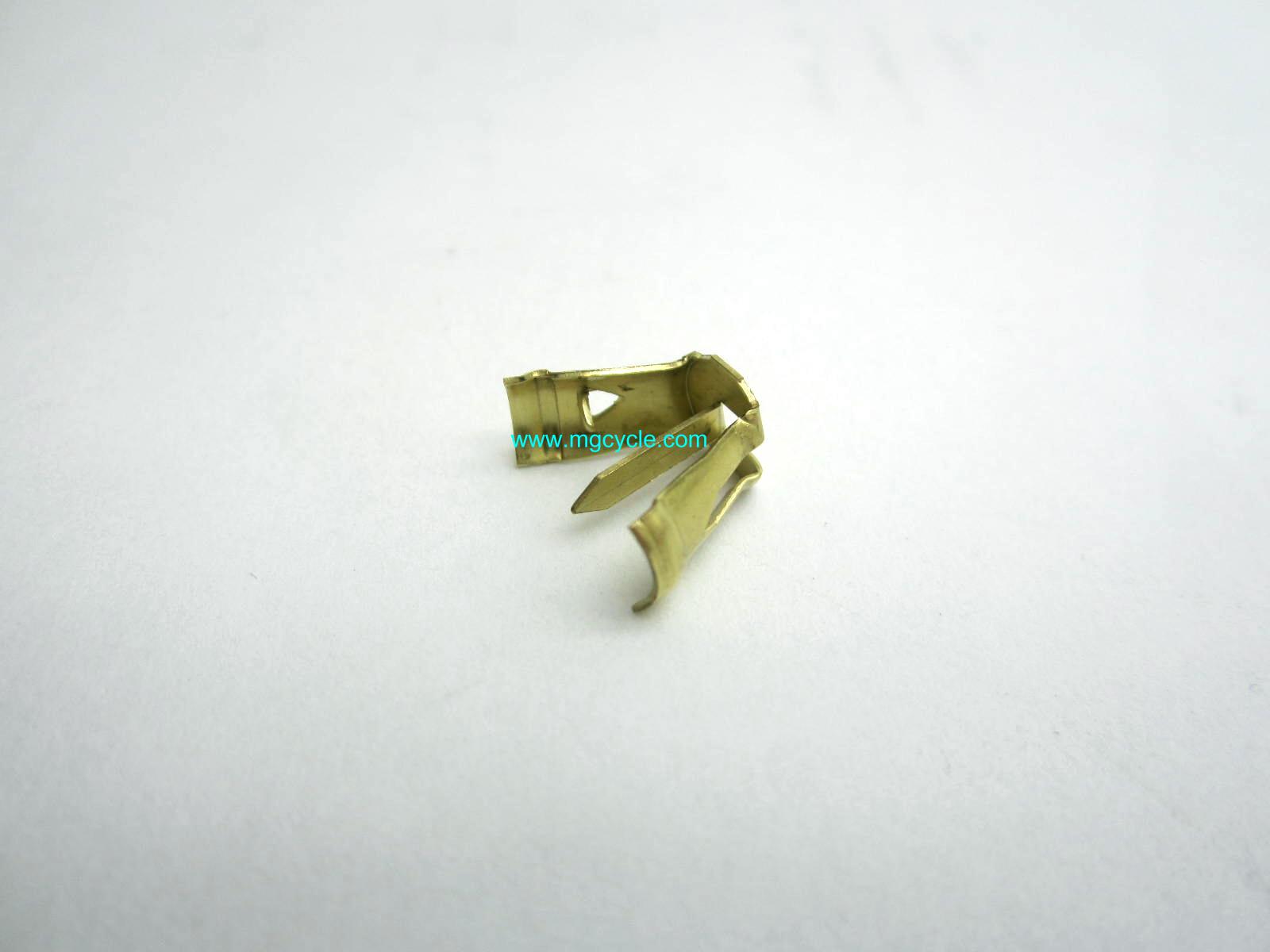

And if you still have your factory wires, they have WONDERFUL soldered-on ends that go into the coil contacts.  MUCH superior to the kind that have a tooth that pushes into the end of the wire, with two arms that bite into the insulation.
Simply de-solder the old tips, and solder them onto your new wires.  Much mo betta.
NOT these!
There doesn't seem to be a picture of any of the solder-ables on the internet.  I guess I will have to take my own.
I would even go so far as to say it would be worthwhile to buy some old OEM cables off of eBay or such, just for the tips.  The older & nastier, the better.
Like these; or these.
Don't buy new ones, I doubt they would have what I am talking about.
I have no idea what BMW/Bosch was putting on after 1990, or so.
