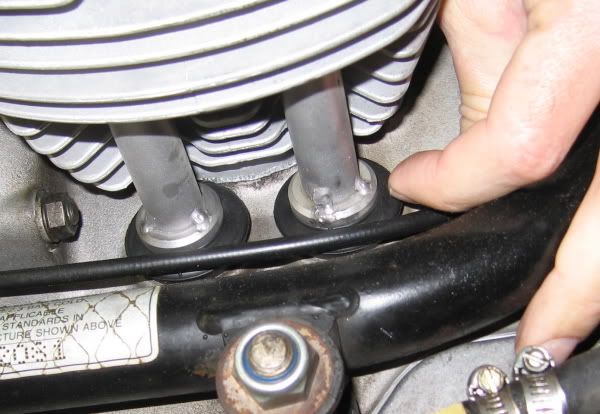

Oh boy... after a 15km ride I discovered a major oil leak by one of the rocker arm rubber seals :(
I replaced both with new ones, and checked they were on the right position... can one of them be faulty? What else could be wrong? :( :( :(

Pushrod seals usually start to leak not because the seals are going bad but because the collar that holds pressure on top of the seal starts to slide up the pushrod tube away from the case wall.  If you tap the collars gently down the tube a bit and then either spot weld them in place or put a hose clamp on top so that they don't move anymore you will have better luck with your leaking seals.
Picture of spot welds on collars:

Hi Bill, thanks for the answer... that makes some sense, but I heard somewhere that on later R65 you shouldnt do this because the collar doesnt move.. is this right?
If not, can I tap it with the cylinder on the engine? If I could walk away without taking the cylinder from the engine again, It would be really good...
thanks in advance for all ideas and help :)
