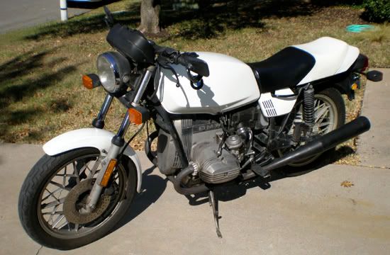

Need a more or less stock seat for the R65 I just landed... Found a nice R65LS seat, but he says it's "slightly different"... What are the differences... Will it work?   HEP... And Thanks!

It won't match up with the standard R65 rear / tail cowling - the angle of the rear seat pan is angled differently to match  with the LS specific rear cowling.   Now, if you get an LS specific rear cowling too, you'd be OK - unless you have a "standard"  unit pannier frame with integrated rear luggage rack, which will NOT work with the LS-specific rear cowling (luggage rack bars run afoul of the LS passenger grab handles).   The separate left/right pannier frames that do NOT have a rear luggage rack built into them will work with the LS rear cowl, though.

Bike came with a custom two-rider touring seat (Corbin? Can't tell) in decent shape, and my wife really likes the plushy seat... So I want to get a second, fairly flat seat to use when I ride alone, which is 95% of the time... The dual touring seat puts me a little too far forward for comfort.

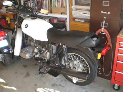

This is the PO's seat cover as it was fitted; two-tone -ugh- with material split in several spots along the seat pan edge and worn through from fuel tank contact. Several rivets in pan had also pulled through the fabric. Pretty rough all over.
NW Classic cover installed along with a vinyl U-channel guard arond the seat pan perimeter. Check with a saw blade sharpening shop; ask for the band saw vinyl guards that they usually toss out.
