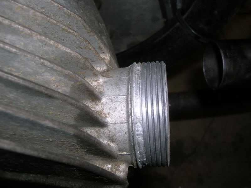

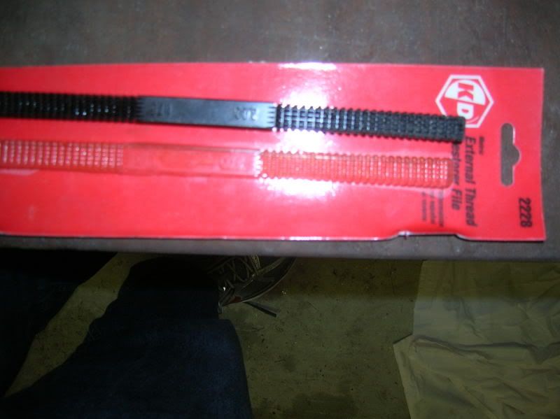

If you find that you still need to do some thread filing on the exhaust threads - I would recommend this handy little external thread file that I bought at a local auto parts distributor.   They have an SAE file and a metric file - you want to get the metric one for working on these bikes - use the 2.00mm side which seems to be a perfect match for the exhaust thread pitch/depth.   The valve cover and USA air-plumbing bits can get in the way a bit due to length, but I think that it may save you some time and improve your accuracy of remaking thread grooves over a single tri-corner file.
Here is a pic of the semi-galled threads on the right head of my R65 (the left head is good) after a short amount of cleanup with the thread file.   With more time I think it it could come out better, but at the moment, I've got an exhaust nut that goes on and off nicely and holds tight, so I'm not going further until I have to!
